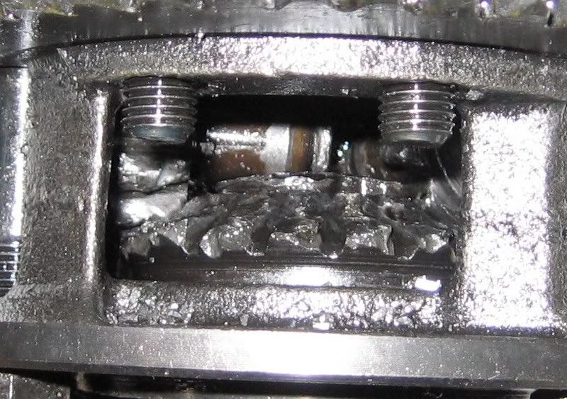

Whining, maybe the diff? My old diff did also within a month the follow result.

Weirdly the diff on my black car gave no abnormal noises before it just went bang :lol:
