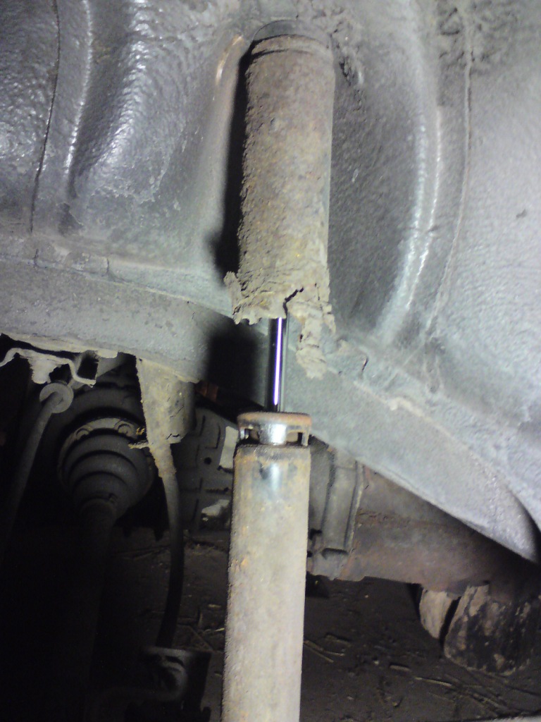

Hi everyone i am just after a bit of advice, jacked my car up today to paint the wheels black and i noticed that the sleeves (or watever you call them lol) on the rear shocks are a fair bit corroded is this a problem? would the car still pass a M.O.T. with them in this state im guessing it wont make that bigger difference but would still be nice to get some advice.
r shock.JPG (196.01 KiB) Viewed 6371 times
l shock.JPG (222.39 KiB) Viewed 6371 times

Hi James, regarding the shock absorbers, it really depends on the MOT tester. However, as a general rule if they're not leaking and efficiency isn't impaired they shouldn't fail the MOT although if it was mine I'd just replace them. Its an easy job and new dampers are fairly cheap.

There is no reason for any tester to fail them on the corrosion provided they are not leaking and are working correctly.

hey thanks guys, the shocks seem to work alrite just the bit rust on them, think i'll replace them later on in the year as we've just been put on a 4 day week at work so not really wanting to spend to much on the volvo at the moment
