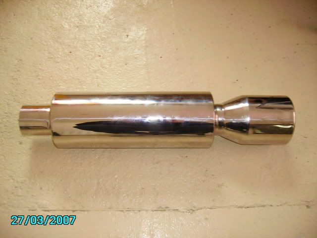

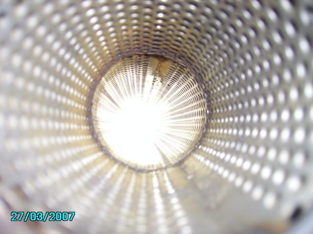

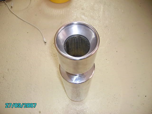

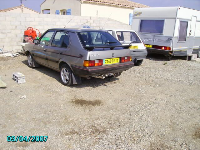

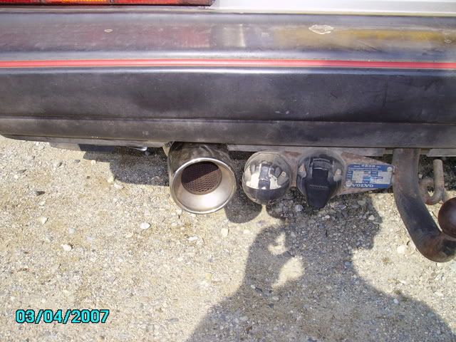

Post by germ » 15 Apr 2007 12:06 am
started off with this:
then made this:
50mm all the way to the the back box with is 63mm 4" tip
i thought it looked funny when i got it but not bad at all now
AND THE SOUND!! WOOHOO!!
Volvo 340 Image 1988
Frits
Posts: 725
Joined: 04 Jun 2006 07:58 pm
Location: Netherlands
Post by Frits » 15 Apr 2007 09:02 am
What kind a sound do you have? I also have kinda system like this. The sound is pretty quit, and very very deep.
