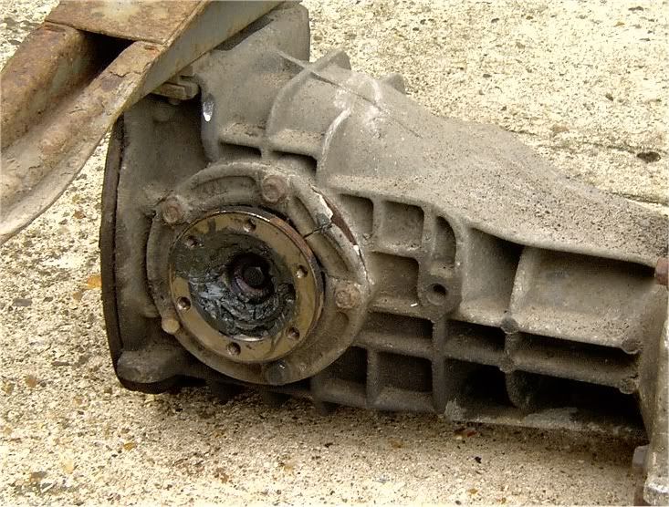

One strange thing we did find was some very odd damage to the diff. on the old 4 speed. It had obviously been done a long time - almost certainly long before Vart aquired the car. I can only assume that it's impact from something on the road (I will of course have it to pieces - can't really help myself).

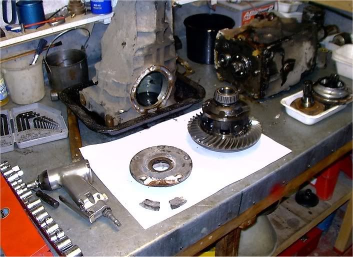

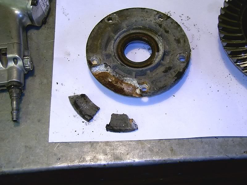

						Varts old box - been on my bench nearly 20hrs and I couldn't resist it any longer - had to have it apart to look at that strange damage.
Diff side bearing housing flange broken away. Diff casing unaffected !
Either - external impact, or someone with a lever (unlikely as main case ok), or just possibly corrosion swell. (crown wheel backlash is adjusted by moving whole crownwheel/planet gear assy. sideways to change mesh with pinion).
Backlash adjustment shims sit under bearing housing and are steel - housing is aluminium - if electrolitic corrosion took off (was evidence of this) it could produce enough pressure to crack bearing housing flange.
Who Knows ? (which way the wind blows).
Note Vart - new diff - nothing on magnetic drain plug, old diff - a veritable forest of metal particles.
Mac.
