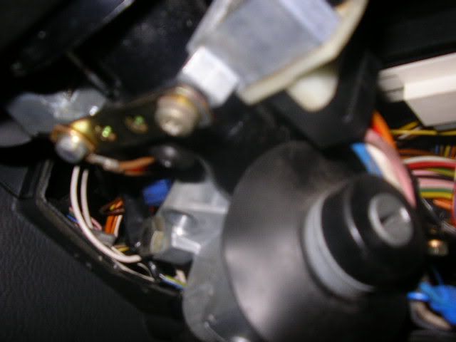

I bet it has happened to most of us here and we all know the problem, the plastic bracket on the steering coloum breaks and then the stalk flops about!
This has happened to me twice now and this is how I fixed it on both cars.
All that is needed is to cut a bit of thin flat bar and drill two holes in it and fit in on to both the stalks.(I used a bracket that comes with some lpg parts)
You could do this before the plastic gets broken to save the inconveinience.
