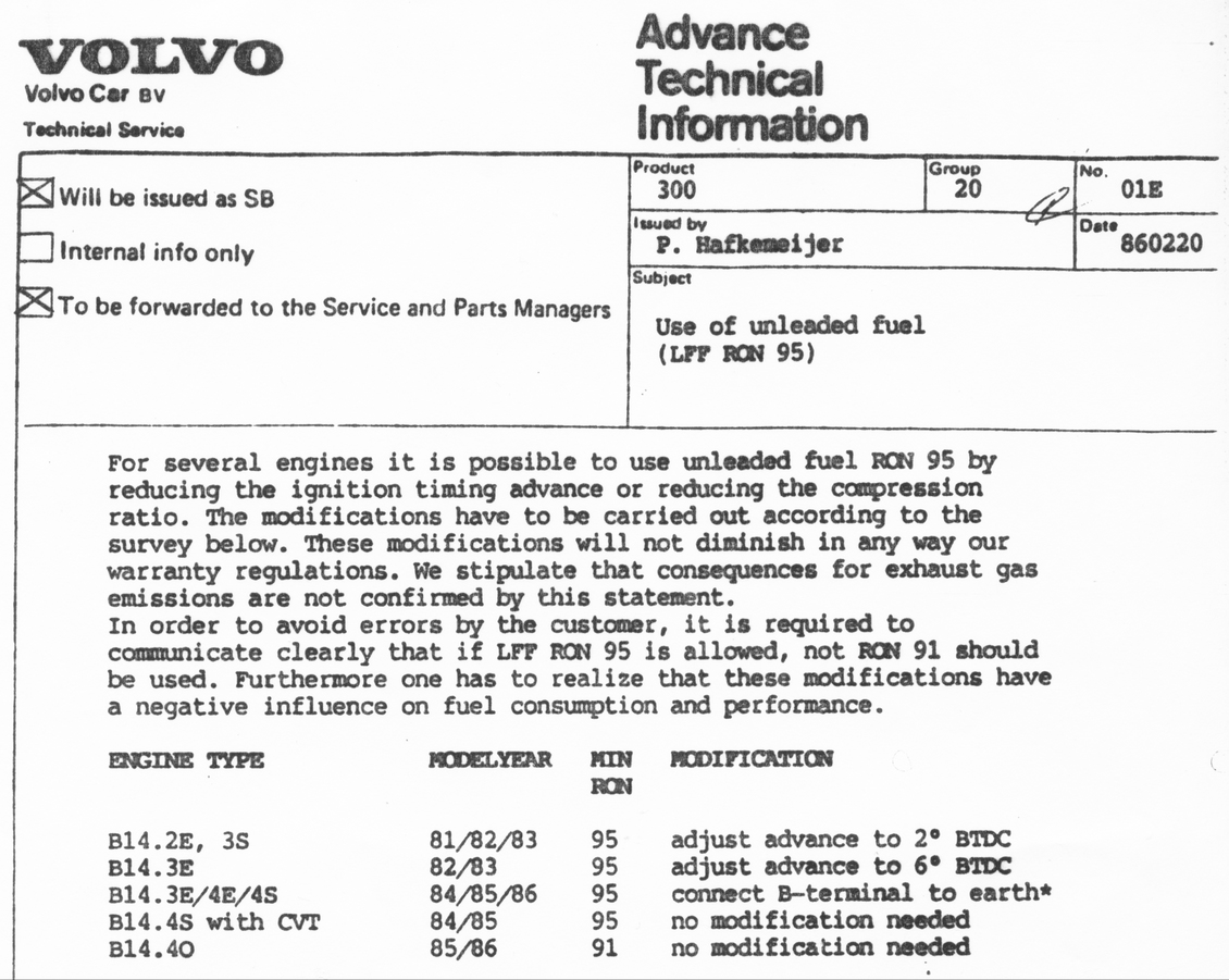

Found this on another forum
Chesh740R
Posts: 159
Joined: 16 Aug 2004 06:23 pm
Post by Chesh740R » 16 May 2006 04:53 pm
The poster didnt know it didnt apply to the 400 series, but i saved it and rehosted it and thought it might be of use to you lot or to put in ya historical files.

very cool info!!
thanks :-)
any more where that came from????

I would like to see how that paper continues as there's * in "connect the b-terminal to earth" That has something to do with renix?

yep only the "B" is strange because normally that would be the connector from the flywheel sensor.
perhaps they meant the middle wire of connector C?
