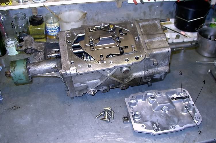

Found an 89 B172 and relieved it of its transaxle - covered in mud and general filth. £35 for whole lot on its mounting frame - not too bad if its a good one.
Back to the lair of the Mac and a good pressure wash (on the front drive - yes the neighbours are moaning) and into the workshop with it.

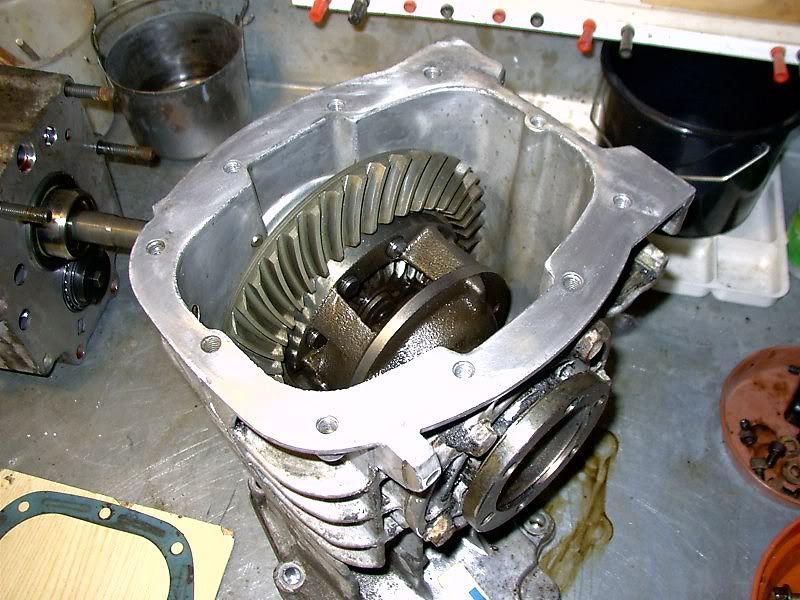

Gearbox and diff were both full of clean oil - no glittery bits, nothing on the magnetic plugs - diff backlash 0.12mm - washed the diff out and engineers blue on the crownwheel - pattern excellent!! - Could be a goody.
Cover off the box - visually perfect - all gears select easily - no wear on selector plates - Could be a goody also.
Sent Vart off to see what gaskets he can buy before stripping further.

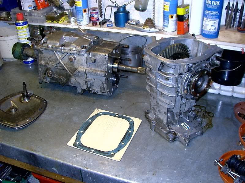

"The transaxle split and ready for checking"
"The diff. cleaned and checked"

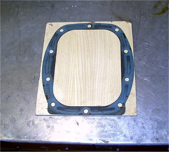

"And the diff. cover gasket" - waiting for me to make a template and start producing new cover gaskets - my new career beckons!!
When I have sourced the correct gasket material and am in a position to make some I will let everyone know !!

Could someone make a DWG, PDF or similiar scan of that gasket. :P I think it would be a good help if someone needs to make a gasket and hasn't got an existing one which to use as a template. And btw what is the thickness of that original gasket?
I think I might replace my end plate as it seems to be a bit battered.. This shop nearby me sells all kinds of gasket materials to use with drivetrain parts, motors, turbo oil feeds etc... I just need to figure out the correct thickness.

Fuse wrote: And btw what is the thickness of that original gasket?
It's roughly 1/16" (1.5mm), cos I bought 1/8" gasket cork, which turned out to be about twice as thick as the original, but seems to work fine, touch wood...

I am intending to produce a template but also to produce some new gaskets but I want to research materials first, rather than just 'knocking a few up' out of cork.
I we are going to have to produce our own in the future I would rather get it right from the start.
The used gasket is made from a composite fibre (asbestos free) blue/green material and is marked with the no.3820 (which I imagine is a material identifier). Used it is 1.2mm thick so Nick is probably spot on at 1.5mm for new stuff.

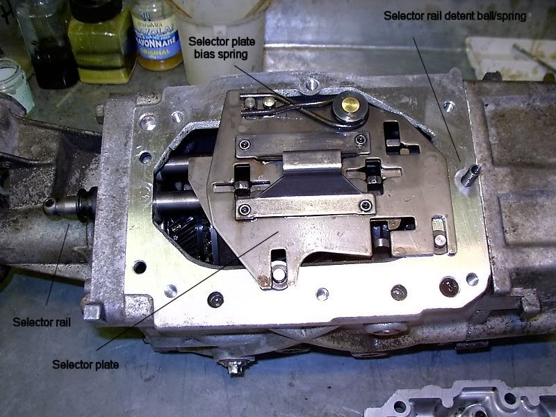

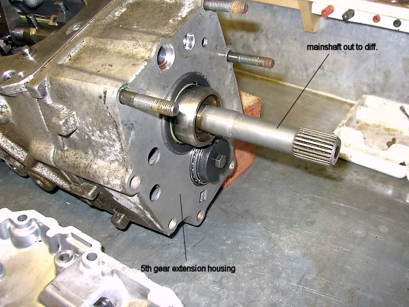

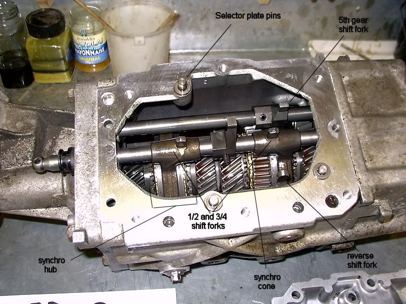

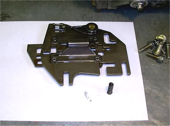

For those of you who havn't had the side plate off an M47R11 box I have added a few captions.
1 is the hole where the detent spring goes, 3 is the selector plate spring. 3 early cars had a plate spring here as well.
Next two picks show the selector plate removed and in place,
The selector plate
The 5th gear end of things

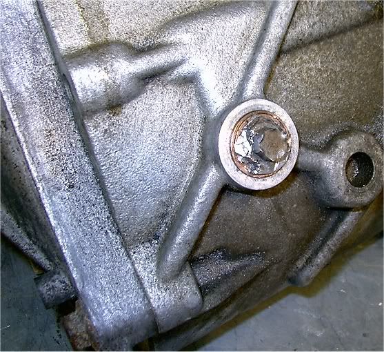

And finally - methinks someone has been chewing on this drain plug!!!!
(don't panic Vart - it's out and the threads are still in the box).
