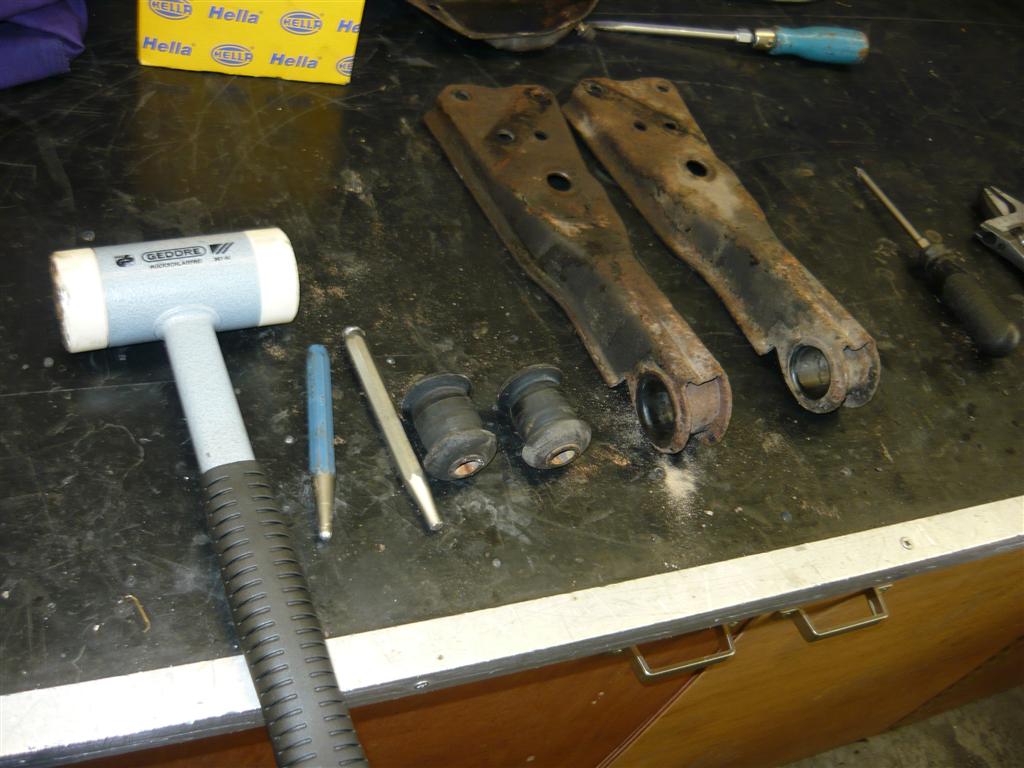

with these tools (on the left):
P1000084 (Large).JPG (102.53 KiB) Viewed 10500 times
and a vice, you should clamp the center bush part in with the top flat against it.
i first held it above the vice and the wishbone bended a little after a nice smack with the hammer, if you're at it you'll see what i mean. i have no experience with renewing these under the car, this was nearly just as easy (only 5 bolts a side)

hmm, i got mines out in like 2 solid blows with the hammer
the trickyest part is clamping in the wishbone in the vice so that the wishbone doesn't bend from hammer impact force, with a hammering tool placed in/onto the steel center of the bush; a few solid smacks should let the entire bush plop out intact..

Here's how it went tonight.
I used:
- a vice
- one short bolt
- one large bolt with a nut
- a hammer
- 2 bearing races from a rear bearing
With this setup I got the 2 bushes out without breaking them :)
