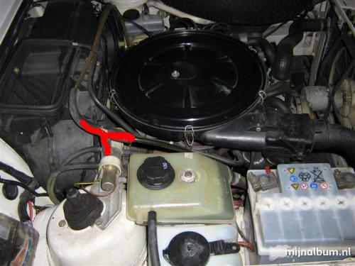

ok, from the carb you have a t-piece; one side goes to the crankcase breather (make sure this hose contains a restrictor). other side goes to the top connection of the EMVK, i'll have a pic up in a minute
Re: ok need help!
Post by volvodspec » 23 Feb 2010 05:26 pm
here you go:

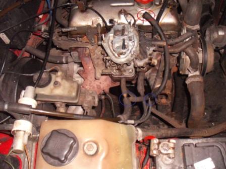

lol ok ...soz bout caps ....heres pic....
2 t-pieces + blue
hose i dunno wot to do with +red
Re: ok need help!
Post by volvodspec » 23 Feb 2010 07:11 pm
ooow, that one goes to the t-piece on top of the valvecover, is for the crankcasse breather.

cheers thats the one! the t-piece had broken (thats why i couldnt see where to connect it..... fixed now and all hooked up
thanx again mate :D
