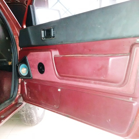

I bought another 360 GL i think it's the earlier model than my current 360. Interior and engine is much better, millage clocked at 60'000 plus. Still have the same problem with fuel pump. This time I can do it heheh.. but still it won't start. I still unable to contact my cousin about the patrol car, maybe he changed his phone number. As for the 2 door gls, I still haven't meet the owner yet. So not so much to be updated here. This car is my second car parked in my mother house in KL in case i go there i have a car. Anyway this thread is still to restore the orange 360 to it's standard condition. Here is some picture of my new buy.

Awesomeness is everywhere. We'll have to find you a red trim panel for that door... Keep up the great work.
Thank you..

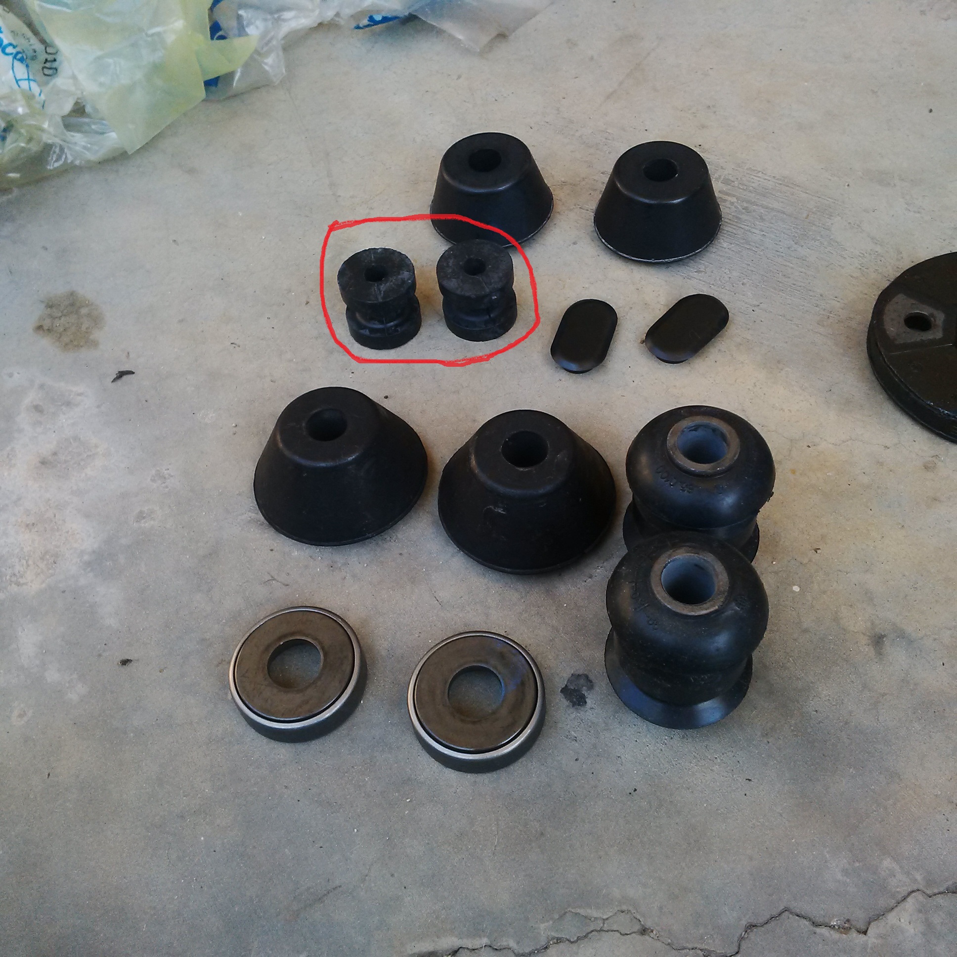

Anyone have information about this car? The one that I notice is the sway bar is different from my current 360. The lamp looks like painted in black inside. Come over to KL next year? Any relative here? I'll be glad to be your tour guide!.. bring some 360 goodies..

The anti roll bar difference is correct. On this age the anti roll bar links to the wishbones as where your later one links to the struts
Which mean, this will come in handy. I need 4 of this right? That's why i cannot find where to put it on the orange.

The two shown there go into the bar and then these ones http://www.classicswede.co.uk/Anti_roll ... 08386.aspx go into the wishbones
Thank you, and yes i have both of them bushes. Another thing is the key have light bulb if i slide it. But no light maybe the bulb is burnt. Very difficult to have small size bulb here.
