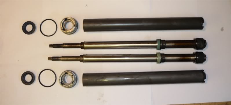

Well well we are full of surprises today !
Finished stripping struts to find damper inserts aren't - they're the old type fluid filled strut casing! on an '88' yr mod.
I must confess I had thought production had used inserts since 84 at least. Certainly only replacement inserts were
stocked from about then.
Foggy was asking recently about fluid qty. - now I know - refill qty. is 320ml per side.

mac wrote: Finished stripping struts to find damper inserts aren't - they're the old type fluid filled strut casing! on an '88' yr mod.
Fakes were too Mac (89 my and build), which is shocking considering her mileage. I'm sure I have a receipt, so I imagine they were re oiled at some point

mac wrote:Finished stripping struts to find damper inserts aren't - they're the old type fluid filled strut casing! on an '88' yr mod.
the fluid filled struts are on all 300's from factory, but as you say all after replacements are inserts now, luckaly!
