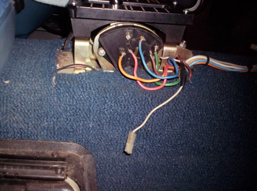

It now appears that most of my Electrical issues have been solved. What a nightmare this has been so far. :roll: :roll:
The Declutch servo is now functioning 100% after tracing back the wiring to this "dangler" under the shifter. Needless to say the connector was cut off and the wire properly soldered back. Push the selector button-servo activates. SUCCESS!
The 343 will start now (with the ignition key) in "P" as well as "N"...as designed. 340pw

Am I correct in understanding that the [s]mechanics[/s] bodgers have tried to circumvent the starter inhibitor to be able to start in D or R? There's such a simple, painless and reversible way to do that... ;)
You are correct...the BODGER tried (and did) circumvent the correct wiring in quite a few places and with the addition of buttons, jumper wires as well as, in some cases, a whole set of new wiring in the harness. :evil: :evil: :evil:
