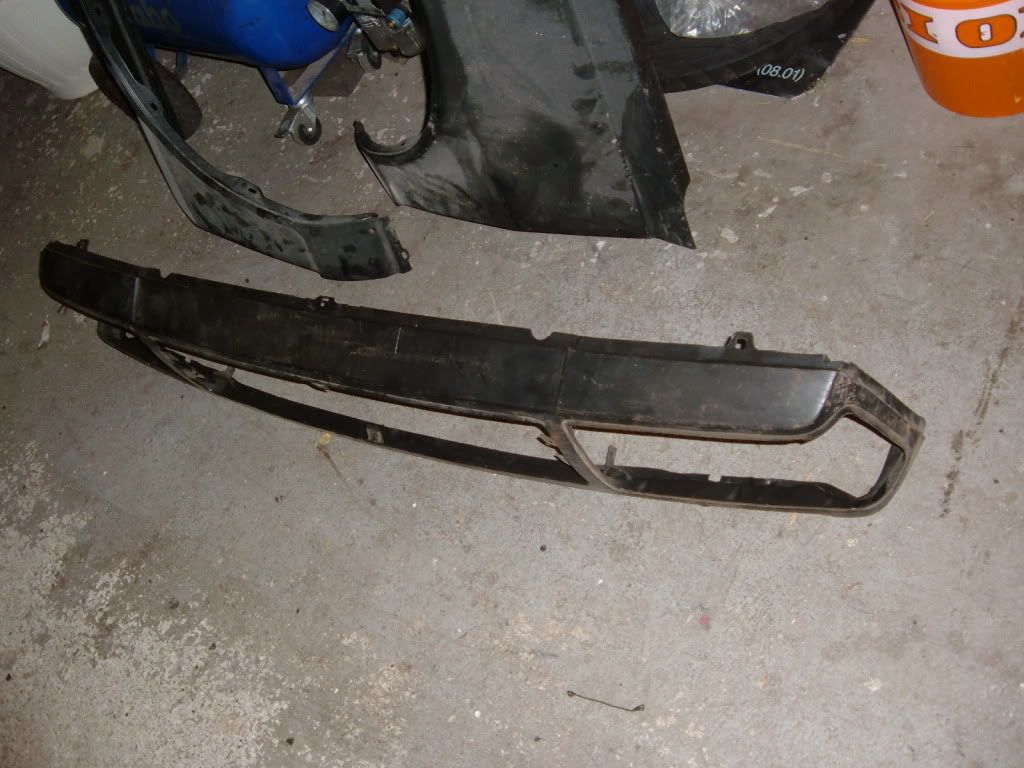

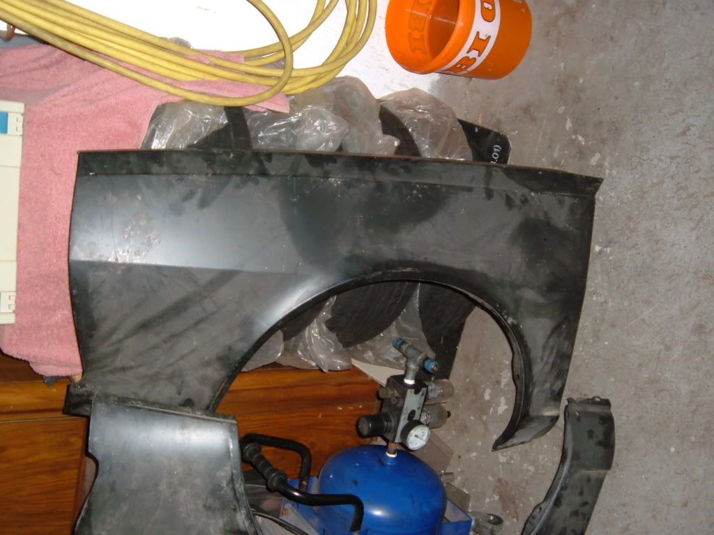

Here are the pics of those wings:
They are the earlier Mk1 version, without the holes for the indicators. I guess they could be drilled easily though, better than the other way around.
He'd like 175 Euros plus postage. If that's an option, send me a PM and I'll send you his email address.

trabitom99 wrote:Here are the pics of those wings:
Tom, they are actually later wings. Volvo stopped distinguishing between the MkI (no hole) and II (holes) wings somewhere in the early eighties and send out a note with the dimensions and locations of the holes so that the panelbeater could drill them if needed. Saved them two locations in the warehouse....
trabitom99 wrote:
trabitom99 wrote: He'd like 175 Euros plus postage.
That is not a bad price, I personally ask more for a NOS wing, knowing how rare the are.
One can offcourse keep an eye out for them on the bay as not many people need them and they do come up from time to time.
Looking at the condition of the car (still awaiting the VIN) it looks to be in a slightly worse condition then my 79-er.
I had had to change the inner and outer sills, part of the floorpan and chassis, front and rear wings, the 2 doors, the sunroof,....
Can you keep an eye out for me if you come across identical upholstery, I could use some bits for my car.
