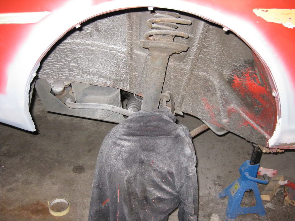

The inner wing however is really good!
It looks like they've been dinitrolled (or equivalent) in the past, and it shows. Only minimal rust.
might have recieved a bit of a knock (bottom left) once in it's lifetime ...

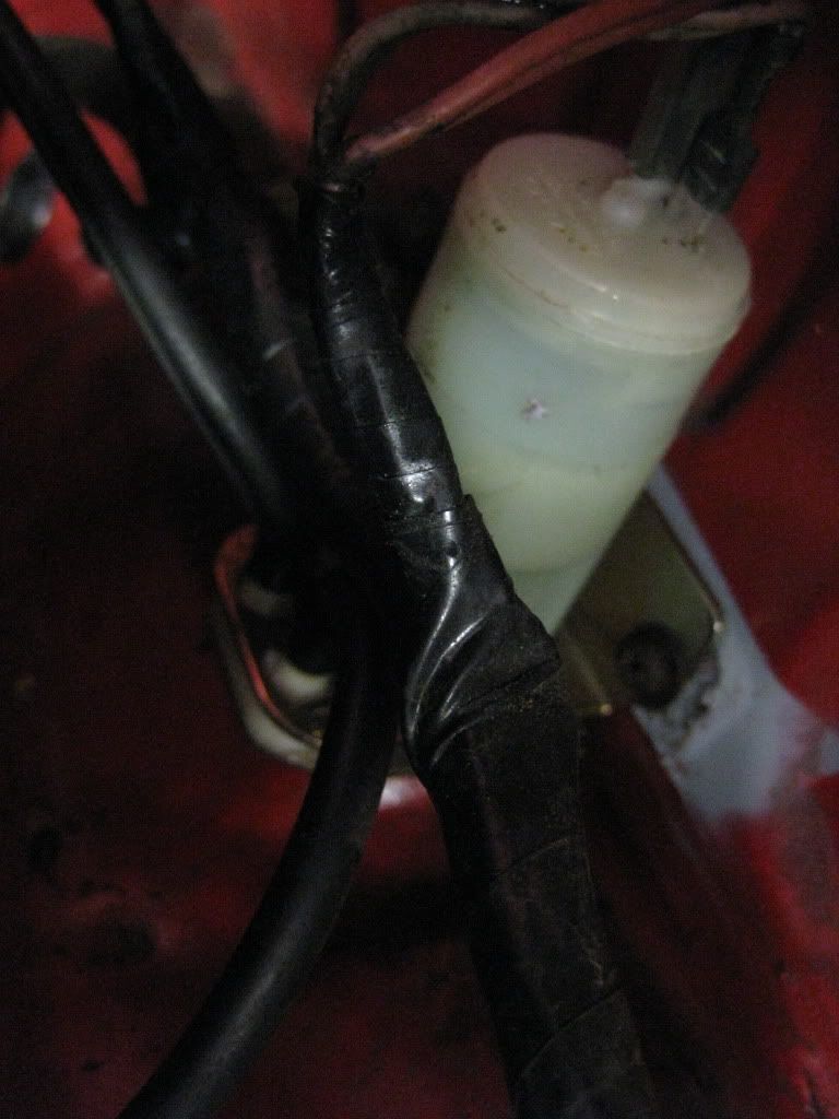

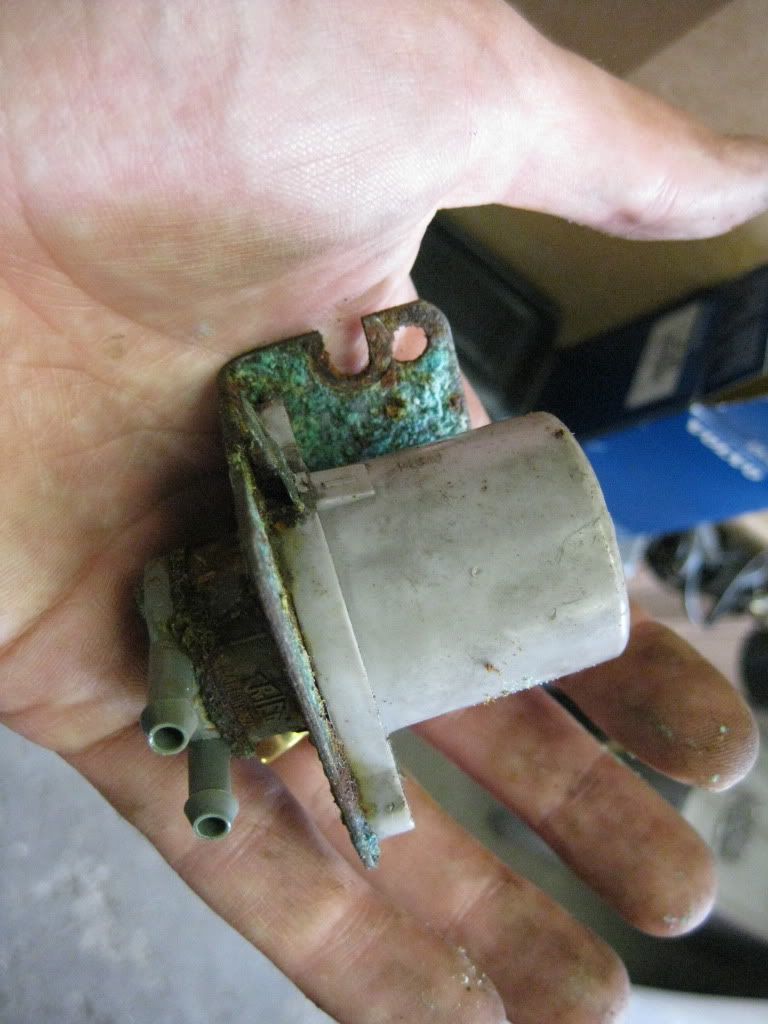

Swapped the washer pumps over
old, and seized up:
new:

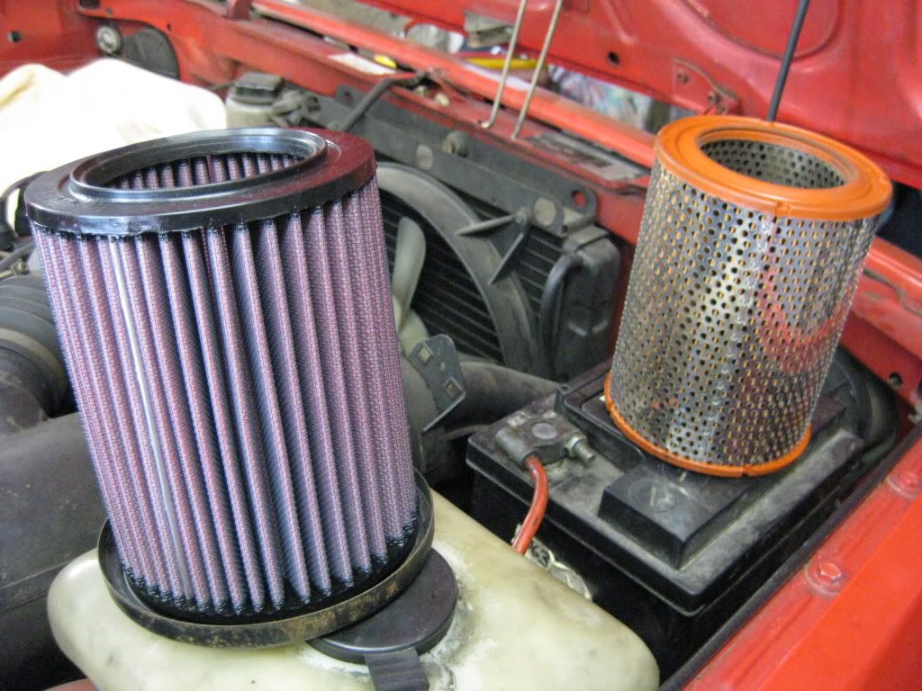

Replaced the air filter with one from K&N - I've heard mixed reports about whether they make any difference or not, but I thought I'd try it out anyway

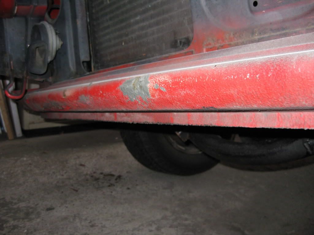

Erm, there's a bit more welding required than "just" the rear arches:trabitom99 wrote:* replace the windscreen washer pump
* find out why the main beam doesn't work
* welding (rear wheel arches)
Both front wings are pretty shot:
old, and seized up:
new:

That is amazing... actually shiney metal - on an inner wing!
Re: trabitom99's 343 Touring getting ready for the MOT
Very tidy inner wings...

Yeah I was (pleasantly) surprised about the inner wings! But there's still the RH side to take a peek at, not sure what to expect there. And then there's the inner rear wheel arches, the LH side isn't so good ...

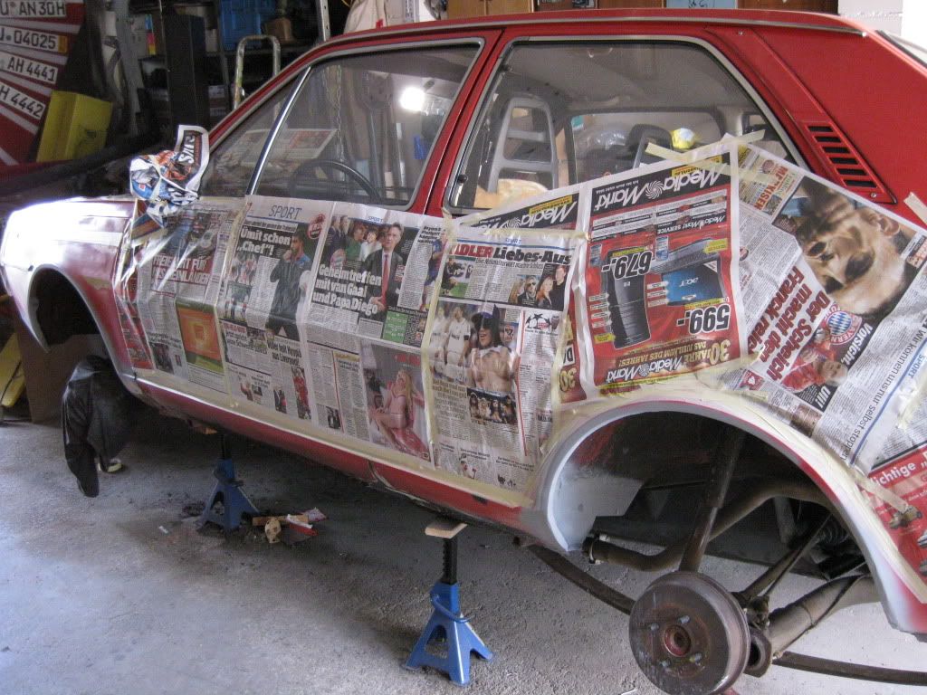

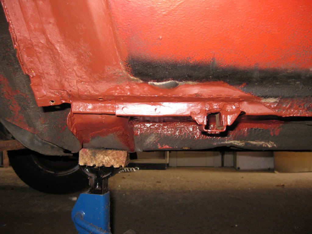

OK, the LH side is now welded up, filled, primed and ready for painting:
Check out the beauty near the rear wheel arch!
For those more interested in the wheel arch:

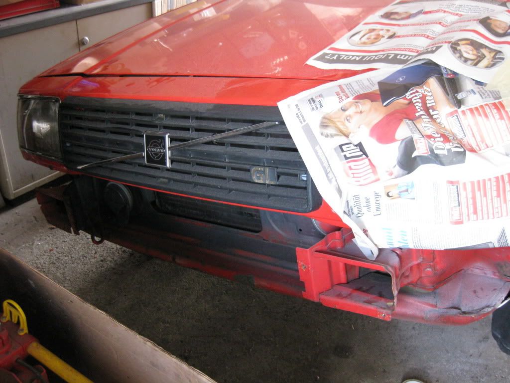

Exciting, isn't itvolvosneverdie wrote:oooooooh.
I like the shiny thing.
that really is the only way to benefit from the bild-zeitung (besides using it as toilet paper).
