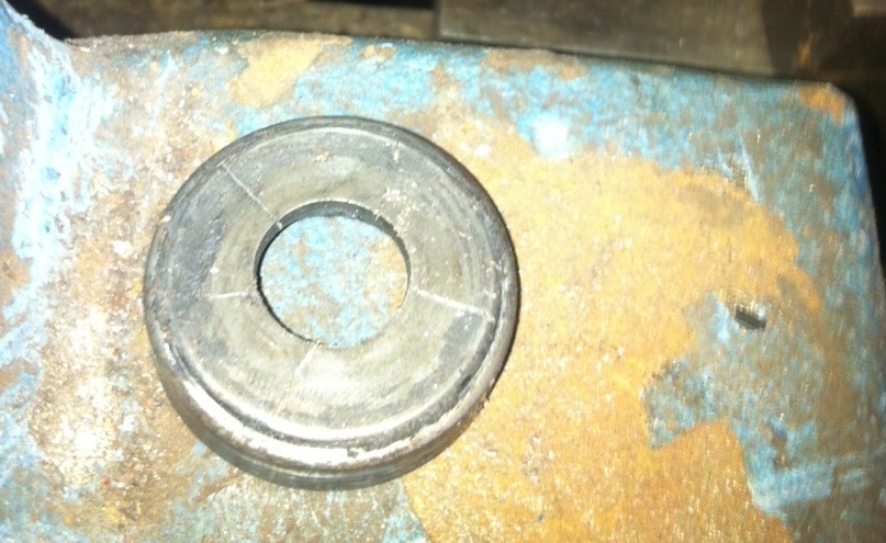

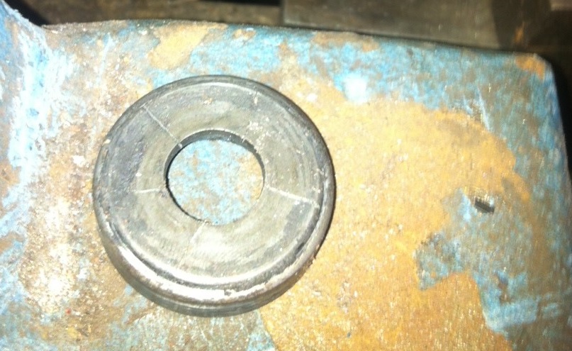

Today I fitted the last bushings. I also reassembled the front struts as they were at different heights. One of the bearings in the strut is breaking. Still works at the moment, but I`d like to replace both. Does anyone have an Idea where I can get them? I'd also like to replace the rubber strut thingies....
This is the cracked bearing:

classicswede wrote:http://www.volvo300mania.com/forum-uk/v ... =9&t=13424
is it the part in the above thread you are looking for?
The strut top - yes. The bearing - no. It*s no. 10:
He he looking great! Will defo get a pair when they are available. Now all I need is patience. Anyone got spare patience for me? sm18

If there is *any* cracking in part 9, don't refit without fixing them!

no10 is the bearing. If RJ does not have some then I do.
And as Chris pointed out check no 9 for any cracks and repair/replace if there is and damage

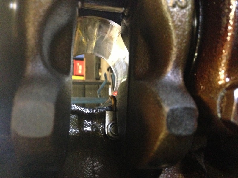

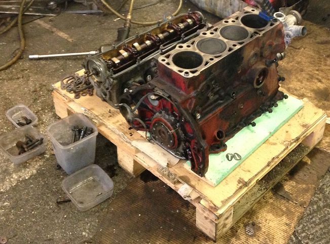

First I stripped the new engine:
I did not know the donor’s build year, but my hopes were fulfilled. It’s got the stronger rods and the oil cooled pistons.
Unfortunately I have some difficulties getting the right pistons. I need first oversize, but can get only Standard “G”-Pistons. Of course I could get forged pistons, but I don’t want to. Any help appreciated!

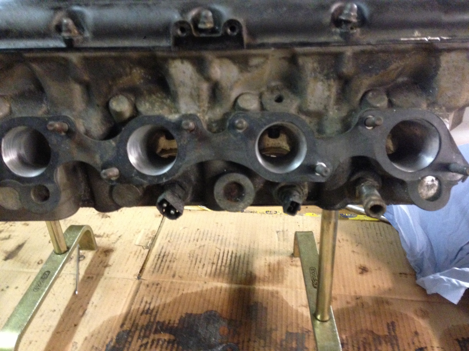

With the block getting honed I spend a couple of hours porting the head and smoothing the canals. First the inlet side – fits the gasket perfectly!
Then I enlarged the inlet and outlet before / after the valves. Rounded a lot of the edges and particularly the outlet side is a lot larger now.
Nearly done – will smooth it again but I guess that’s it then. Maybe I will enlarge the ports to the exhaust manifold, but at the moment I think I won’t. Main target was to allow the exhaust gases to exit the chamber more easily.

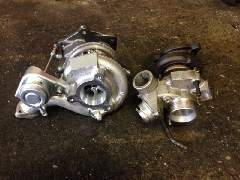

Finally, the turbo for the car has arrived. Hint: not the 19T… :mrgreen:

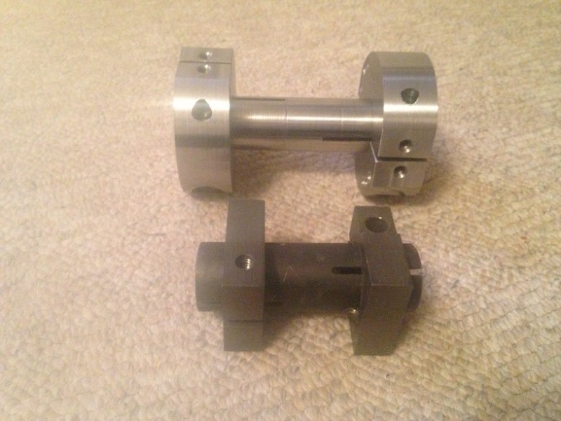

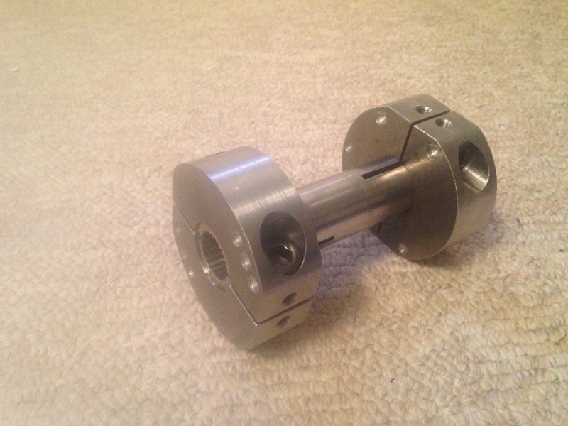

Anyway, last week I could finally collect the new, stronger flange that I had made:
Looks like an Arnold Schwarzenegger-memorial-dumbbell. sm23 Quite likely it is now the strongest part of the drivetrain. And yes, it does fit into the torque tube, with about 1mm to spare all around.
Comparison to original part:
Measurements:
Length: 120mm (original part: 80mm)
Diameter: 73mm (original part: 64mm diagonal)
Weight: 1.499g (original part: 457g)
The length might be a problem when assembling the drive train. On the plus side, the contact surface is a lot longer.
The weight difference is significant, but I have been assured that it’s not a problem. The diameter is small enough. Of course it has been balanced.
Changes are:
- Only two slits instead of three
- Two bolts per clamp instead of one
- M12 screws for the clamp instead of M8
- Two grub screws per M12-Screw to lock the screw instead of ...err… none
- Stronger clamps
- Stronger stainless steel
To access the screws, I will have to drill new holes into the torque tube.

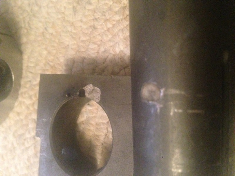

The welding point of one of the original part’s clamps has broken, taking a chunk of cast iron with it:
This won’t happen with the dumbbell…

Posts: 2265
Re: Project: Volvo 360 GLT for the Volvo-Trophy
Post by Ride_on » 30 Jul 2014 10:36 pm
Interesting clamp, have you got a price and supplier? Very interested to hear how it holds up.
I did think that normal steel was stronger than stainless, stainless is brittle, but the oversize may compensate, and the bigger bolts less critical on torque. We need an aftermarket part anyhow. I do wonder why Volvo didn't use a sleeve with maybe a locating bolt. Works for the clutch and diff!
The original clamp is certainly tightly engineered howver I believe it works when used as the designer intended with new bolts and an accurate torque wrench, up to around 250bhp. The weld is just to position the clamp, I presume it broke when the bolts failed.
