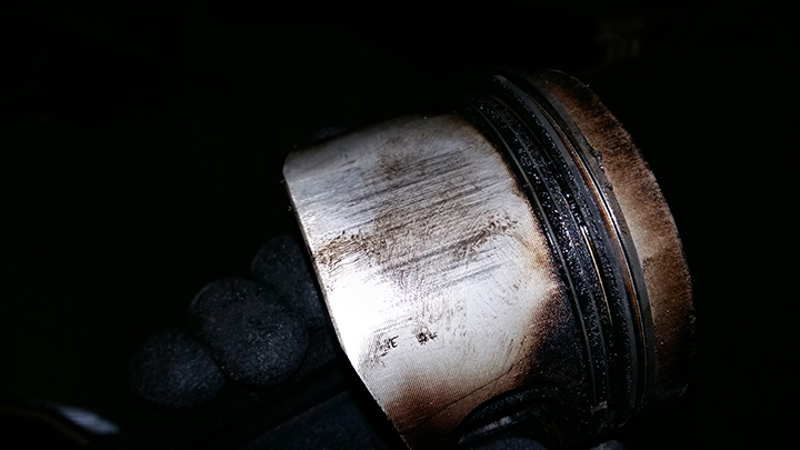

Post by Gabor » 03 May 2017 02:07 pm
and the pistons semms like this:
360beast
Posts: 873
Joined: 27 Dec 2013 08:40 pm
Re: speciale 25 glt+T
Post by 360beast » 03 May 2017 06:19 pm
You can use the b200 bottom end no problems and you don't even need to lower the compression. A few people have turbo 360's with 10:1 compression. I have a b230et to go in my 360 one day and I am fitting 13mm rods and raising the compression to 9.8:1 with different pistons.

Now the engine is out of the car, and I've a few questions.
First of all, Is it possible that the factory used double head-gasket originally?, Shouldn't the piston be plane in a B200E?
Thank's!
Post by SteveP » 02 Oct 2017 08:16 pm
The domed pistons I believe were fitted to the higher compression ratio cars, prior to 1987-ish? Perhaps the bottom end has been changed and the second head gasket added to lower the compression ratio? I don't think it's at all likely that that dual head gaskets were fitted from the factory.

Post by Gabor » 03 Oct 2017 09:35 am
SteveP wrote:The domed pistons I believe were fitted to the higher compression ratio cars, prior to 1987-ish? Perhaps the bottom end has been changed and the second head gasket added to lower the compression ratio? I don't think it's at all likely that that dual head gaskets were fitted from the factory.
I've thinking in a similar way, about the pistons. The car is manufactured in '86. Most likely the machanics used the double gasket to compensate a previus machine work on the engine-top.
But I had an another maybe dumb idea, that they use the double gasket in the factory to compensate the high compression pistons. Cause It's a Swiss market car, and at the time there was pretty strict rule for emissions.
I think that is the reason as well, why the engine has a complex, but rather wierd crankcase gases return system on it.
