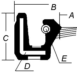

Jani - is that the cam seal with the goop on it? If so, that's supposed to be there. You need to apply sealant to the front cam bearing cap, either side of the seal, or it leaks. The other favourite mistake is to push the seals in too far. The should be flush with the outside....not in as far as they'll go.

There is metal frame at outside of seal and that should be outside from seals 'nest', afaik. I think it is some sort of goop in that, but it did look that it was installed bit wrong, seal did leak quite well.

The spring / hoop is supposed to sit inside the rubber seal - on the inside of the outer of the two 'lips'...if that makes sense!
I had the exact same problem - and it was because I had seated the seal too far back, and the oil pressure was trying to blow it inside out. I moved it out, flush with the front face of the head, and all was well :) Check it isn't damaged, though. I broke two seals before I figured it out :(

I think spring is ok, with metal I did meant metal structure that is inside rubber, bit difficult to explain :oops:

Post by jtbo » 21 May 2008 07:17 pm
I found a pic as I did remember I was meant to draw one :lol:
D is metal which I meant, so what you say about not pushing fully in confirms what I thought :)
