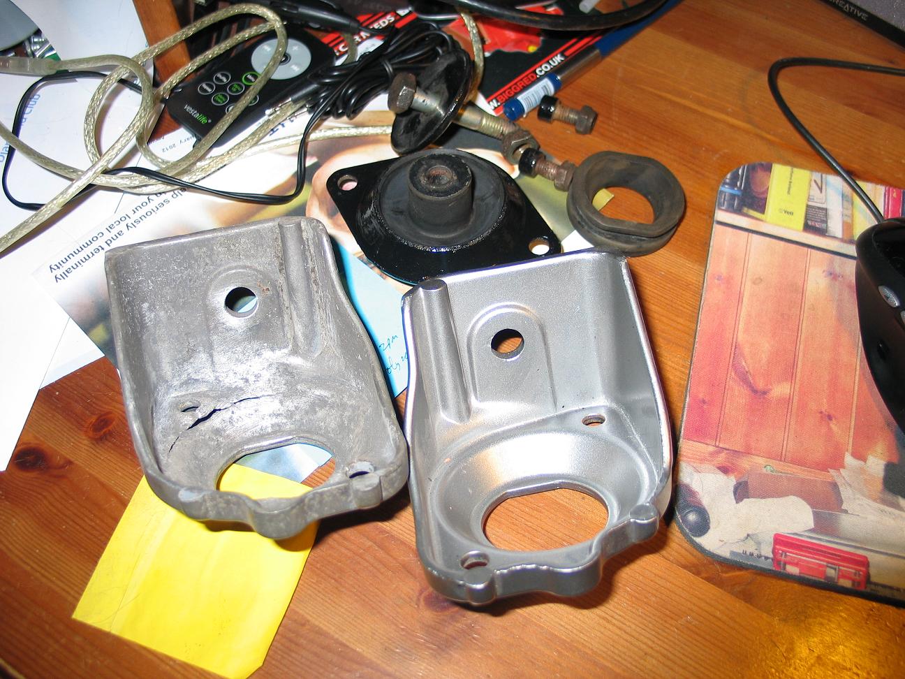

As we all know the gearbox mounts are NLA so I had to get a bit creative.
It's a Trelleborg NOVIBRA industrial mount (quite expensive for a rubber mount, almost €50/piece) combined with some self made nylon bushing and a piece of old rubber for centering/cushion. Though I think I'll switch the nylon insert for a steel one as it's made out of steel in original ones. I just had some nylon plate laying around so I used that for "prototyping".

Interesting solution for the gearbox mounts, but the aluminium brackets look a bit cracked. Probably worth painting the brackets and/or bushes to stop Al-fe corrosion. Mine where well wasted around the inside of the dome, I've got 1 new bracket and 2 new bushes (bought before NLA) I plan to strengthen the other bracket with Al welding.
360 diff brackets

Yeah I'll paint those before installing. Structure of the alminium brackets is ok, it's mostly underseal, oil and dirt and the pics make those look worse. :P
