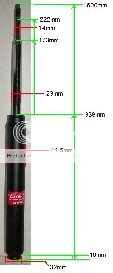

You can get KYB Gas-a-justs (or whatever it is...) which fit right into 300 series struts. They won't be super-stiff, though. I have a set on the shelf, so I can dimension them if that would be useful...?

I'm happy to measure them...but...I'm about to go to bed, and I'm not going to be around for a week or so after tomorrow. I might have chance tomorrow night...post me a reminder tomorrow!

Re: Saxo VTS shocks???
Post by foggyjames » 27 Aug 2009 01:14 am
Hopefully that's of some use. The diameters (except the base) are a bit of an approximation, as I couldn't find my caliper gauge...so I had to measure round and divide by pi.

Thanks for the measurements. That makes my saxo ones quite different :oops:
