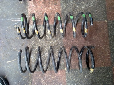

Dai replied and said that it could be the struts...is there anything wrong with them ???

By the way, I measured the free length of my old spring and it is about 330mm not 312mm like the specs I have found on the forum...do you have any new 360 GLT spring so we can compare...and see what's the right mesure ?

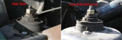

Have you made sure both dampers are working correctly?
If one is sticking it could make one side higher or if one side is not damping that side would sit lower.
The other thing to check is to measure from the spring seat on the strut upto the top where teh damper nut is. the measurement should be the same both sides.

Post by dfeghali » 30 Jul 2010 09:12 am
FINALLY the problem is solved !!! :D
I have found brand new 13mm diameter springs & approx same length as the GLT ones (I think from Mercedes Benz but the guy at the shop doesn't know initially for which model they apply :oops: )...The car sits now a little bit higher than standard but straight ( 40.5 cm from the center of the wheel to the wheel arch) !
Thanks a lot guys for your helpful tips ;)
