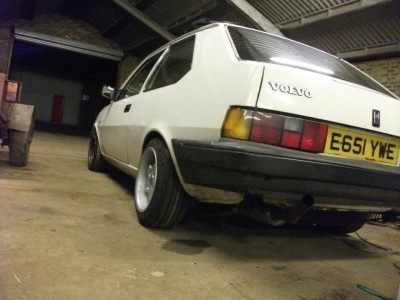

Silver wheels are blocks b5 14x8 et 24 ...I have them for sale right now mate if you fancied. £150
The multi coloured are weller wheels 13x7 et0 I think. Equally cool just ever enjoyed the arch gap they gave
Your decision, but I would not go 15's

Olliehood, wich rims are the rare painted?? They are beautifull and i need somethig like this in spain, because the ITV(tuv) are a f#^}#\@, and with13's i look like good boy jijiji
