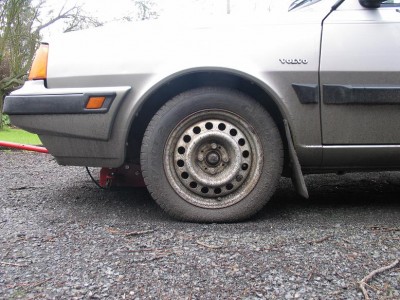

The original e30 steels are 14x5.5, same as the GLT rims. They used to give them away. My tyre dealer forced my dad to get 185/60x14 onto my mums car when the orginal 13" wheel where rusty and leaky (late 80s). I was beside myself.
