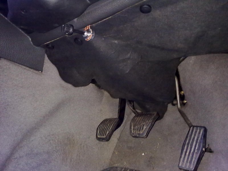

A bit of bathwater being used to re-shape the underdash trim panel...
... hopefully to get a good-enough fit.

I have indicated how the wiring goes from the battery via a fuse, as shown lower down.
All else seems to be fine and the trim parts have been refitted but I must remember to refit the clip to the brake servo vacuum hose.
The setup still seems to work fine so attention will turn towards the rear, nearside spring which seems a bit saggy, as well as the front seat belts which don't retract very well.
P.S. Must check the air vents are working fine with all the remoulding done to the ducting by use of a borrowed heat gun.
