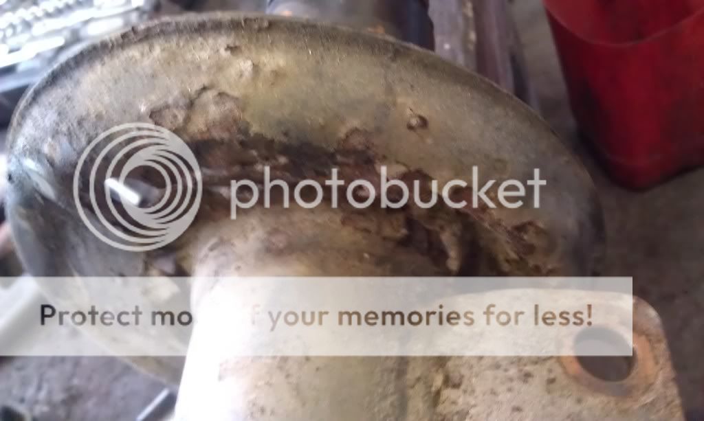

Got the struts off today. There was a few things wrong!
Firstly this:
That was nearside
Secondly:
That was offside
So the collapsed spring cup explains the rubbing, its very worrying because when I put the springs on I had checked it, perhaps it show how fast the damage can come on with some harder springs.
I got the top cup welded back together and the spring patch to drive it the 3 miles back to my drive. So I need to get a new spring cup.
The nearside and offside (allowing for it being bent) spring cup match exactly with your measurements macp
thanks!

Re: Dodgy struts
Holy crap! Must have really been giving it some!
Re: Dodgy struts
Those top plates are pretty weak after a bit of corrosion, mine cracked out through the 2 layers leaving the shock shaft to move around. For a short while, if I use full lock (eg when parking) and I had to turn it to the opposite lock to straighten the suspension. On the older version the rubber cover protects the joint much better and they never had problems AFAIK.
The steering top bearing sits in there so difficult to weld on top, need some clever tools to grind it down.
Re: Dodgy struts
Its been welded back together, I got someone else to do it, he drilled holes in the smaller dish and welded it on, aswell as weld up the cracks. Seems to be fine
When I get the new spring cup I need to compare it all again to make sure its all right. One concern is that one shock has more thread sticking out at the top than the other. (if that makes sense)
