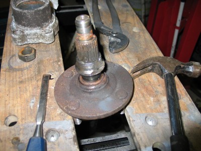

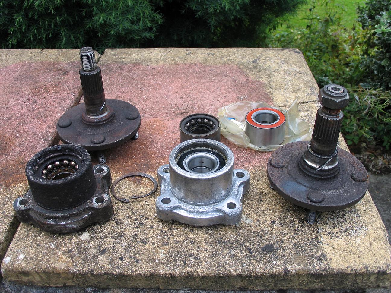

Just been doing some refurb on mine was going to post a full series on it but havn't gotten around to full reassembly yet. Highlights;
Inner Shaft can be pushed out with puller, but takes part of the bearing with it.
Part bearing shell (inner) needs to be cut/ground carefully from the hub shaft, it will crack once thin enough. Take your time.
Bearing can be hammered (heavily-sledge hammer job) out of the alloy hub casing with suitably sized socket, probably hotter the better but I didn't try heating for removal (didn't want grease all over my oven).
For reassembly, put hub case in oven (+180C), and bearing in freezer (-19C), for about 30mins. Coat bearing surface in grease and drop straight in, ready with hammer if necessary. Allow to cool.
You'll need new circlips.
I think 360s have mostly been all the same, my 83 one was the same as my 87 one, generally indicated by the large lump on the outside of the hub for centering the wheel (ish). (edit to say , I think my 83 one must have had a axle replacement)

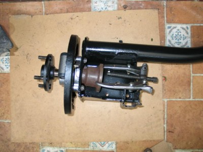

I've edited it to say 'shaft' can be pushed out with a puller, use the same job you used to pull off the CV flange but hook it onto the aluminium hub/bearing case (this may be easier if the hub is removed from the axle..more tricky bolts, need allen key or hex drive bit with spanner). It doesn't need a huge amount of force to break the bearing apart. Getting a puller to fit to remove the flange can be tricky, a well fitting one may not be strong enough, heat and tapping will help aswell.
Also worth noting is a technique for removing the CV joint bolts, they can be pretty tough. I use a crow bar hooked into the wheel studs to brace against the ground, then a 10mm hex socket (ie 6 sided) with a 3/8" drive. 1/4" is too weak, and 1/2" is too big to fit in around the rubber boot.
The crow bar in the wheel studs is also useful for removing the large 30mm nut that secures the CV flange. This is also a difference with old 340s, they use a 36mm nut I think, which can be hard to get a socket for unless you go to 3/4" drive.

you wish
hammering the broken one out might work, but there isn't enough space to get the new one in.
best way to get it out is to remove the hub shaft, that involves the setup on the pic above yours, including a torch...

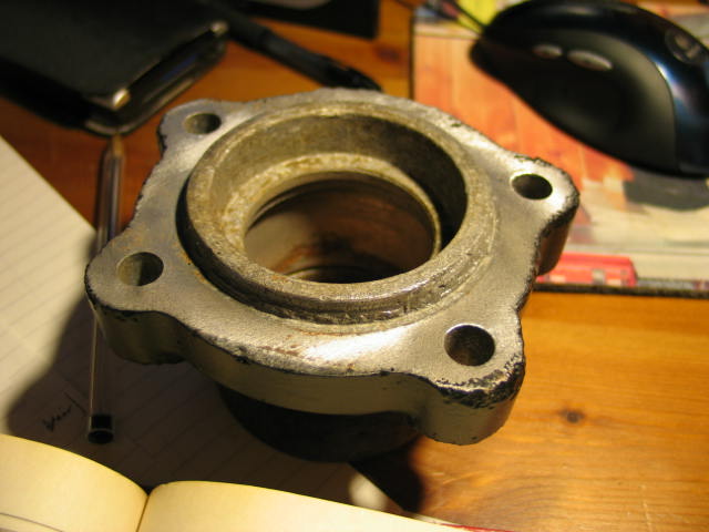

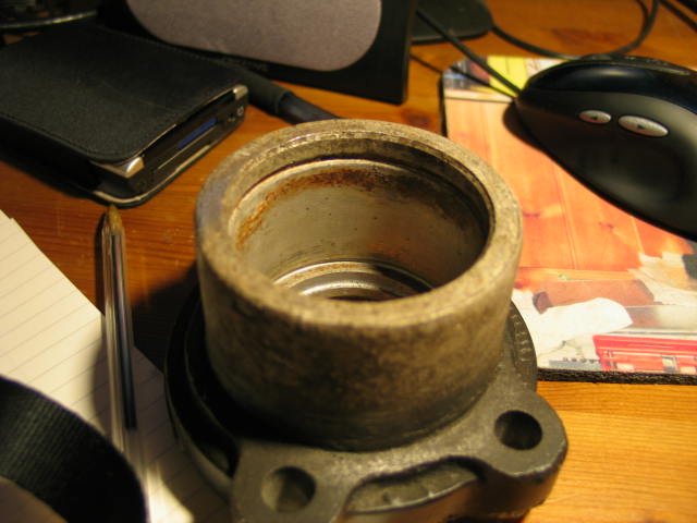

Re: 300 Wheel Bearings
Hi ride_on.
It's this collar I'm talking about.
How did you remove that?
BTW, Thanks for great pics
Cheers.
Peter
Cheers.
Peter

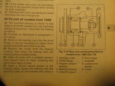

It doesn't look like a 360 bearing. Are you sure its a separate part, try cleaning it to see if its part of the aluminium bearing housing. It could be the spacer in the old 360 bearing, apparently you should drive that out with the bearing using a drift (after applying some heat). Do you have parts of the bearing still in the housing?
The 360 bearings are much simpler, just a sealed bearing and a circlip, the older cars have all sorts of separate seals. The Haynes manual says 360s pre 86 had the extra seals but, my 83 360 has the simple later arrangement with the labyrinth gland same as my 87 car so I think this is incorrect. It doesn't have any diagrams for 340s.
The 340 instructions just say to drive out the bearing from each side using a drift after heating the housing.
