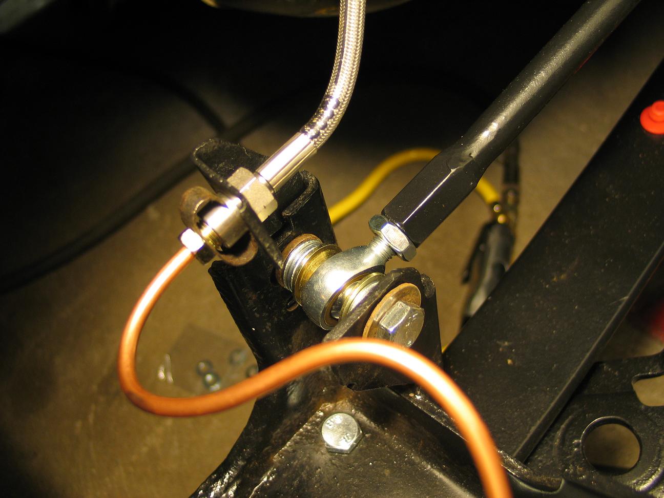

Well I got 2 M10 rose joints in the end, cut the ends off my old radius arm (15mm OD, 11mm ID pipe) welded on some hex joiners and packed the joint out with washers.
If it needs a big adjustment it will be ackward because I got 2 RH Thread rose joints. I could have gotten one LH thread one and the arm would have been adjustable by turning the rod, but the LH thread nuts etc were only available in large packs, and I just didn't need the flexibility.
Also got some rubber boots for the joints, that will be fun trying to get them on, its thread a camel though the eye of a needle job!.
All done now and just need to adjust with the weight on the wheels + dog in boot (she is a handy 25kg). I might try and adjust for level axle base. I hope it won't be too noisey without the bushes, am aiming for a luxury sport with all the sound proofing
