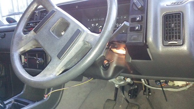

Dosing the fibre-panel that goes above the driver's footwell with hot water and re-shaping it over a pudding bowl followed by weighing-it down with a couple of bricks has allowed it to be re-fitted reasonably well. The steering wheel has been aligned and torqued-up. All seems to be awesome and even the horn works.
The rheostat is left showing for now but will be put out of view when I am happy with the setting - currently it seems best to leave it at about the 3/4 mark. Hope some of this helps.

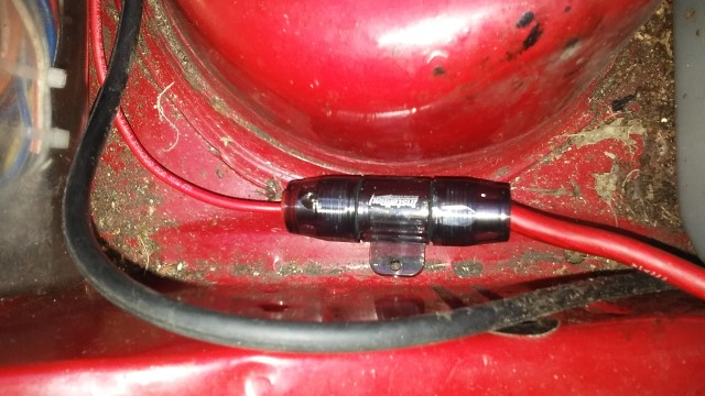

I forgot to mention its all running from a nice little 40 Amp fuse...

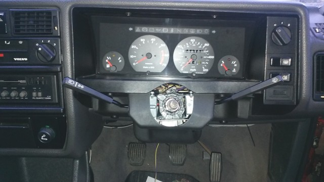

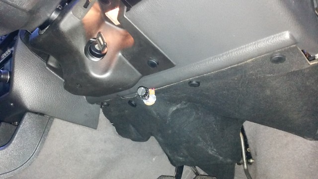

Converting other 1.7 now. Not so elegant removal of the ignition switch backplate is in progress...

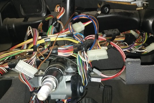

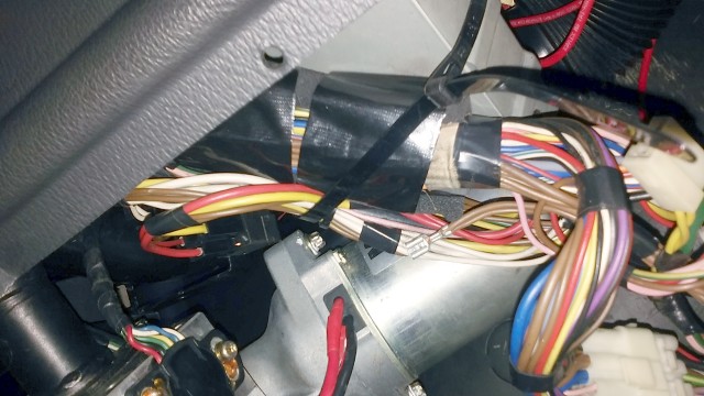

Its all a bit more apart now with the ignition switch and column bracket removed.

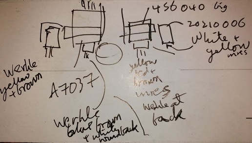

For replacing the relays, here are some notes.

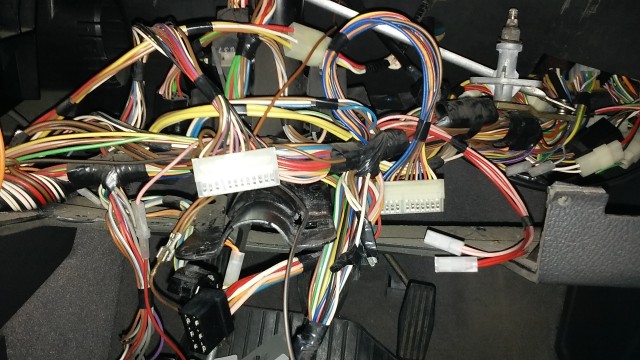

Hello again, long gap in comms. Here is the latest set of photos showing the new EPS being fitted to the beautiful deep blue 1.7...
... so far so good.

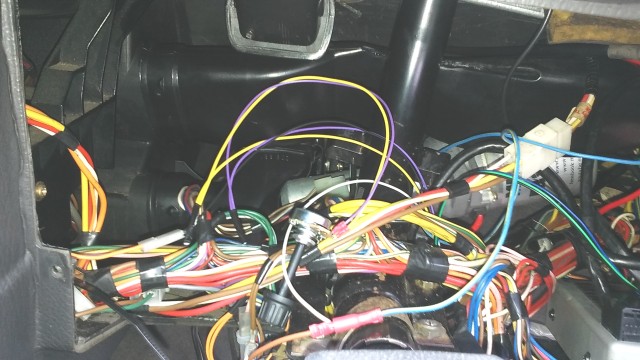

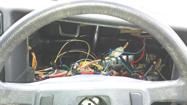

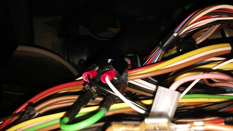

Hello again folks, a bit more progress on the power steering for the deep blue beastie.

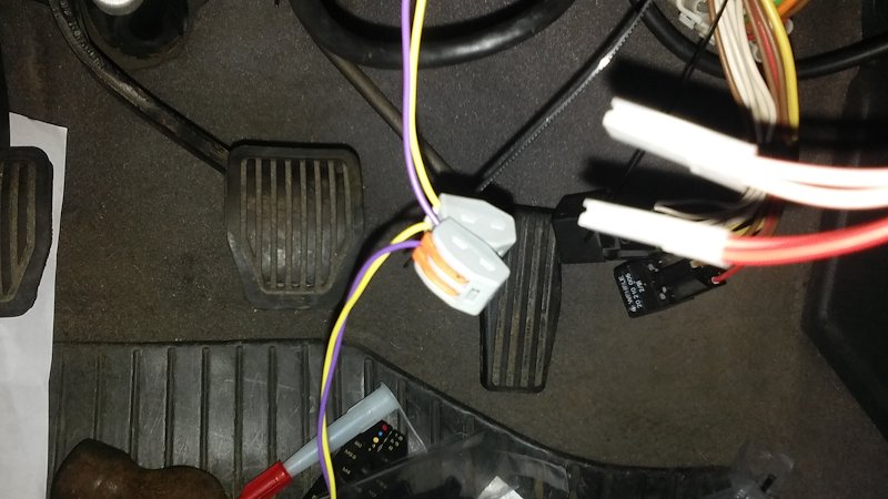

It is all wired in and seems to work well when tested, so it shouldn't be long now.
N.B. I think I had the black and white wires the wrong way round at this point which causes the power steering not to work. I also remember that one of them had to be connected elsewhere in the end to make sure that the PS only came on when the ignition was switched on, otherwise it stays on all the time and presumably drains the battery or knackers itself in no time at all. So whilst the black and white wires look wonderful slotting into that connection block, it is actually incorrect to wire it this way, sorry!!
