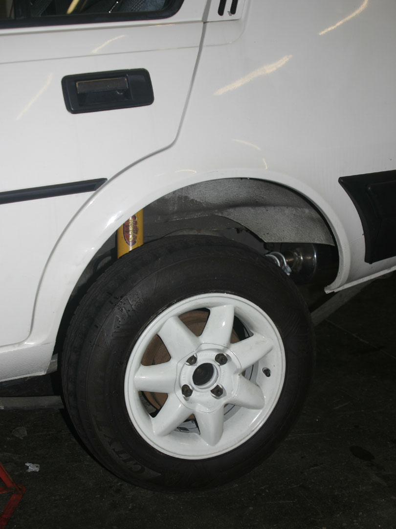

So Ive fitted some steel lowering blocks I got from Adam (340GLT).
While I was at it I put some landrover shocks on, just to see. I still have the front end of the car to sort out so It wont be going anywhere for a while yet. It is super stiff at the back now, as expected :D.

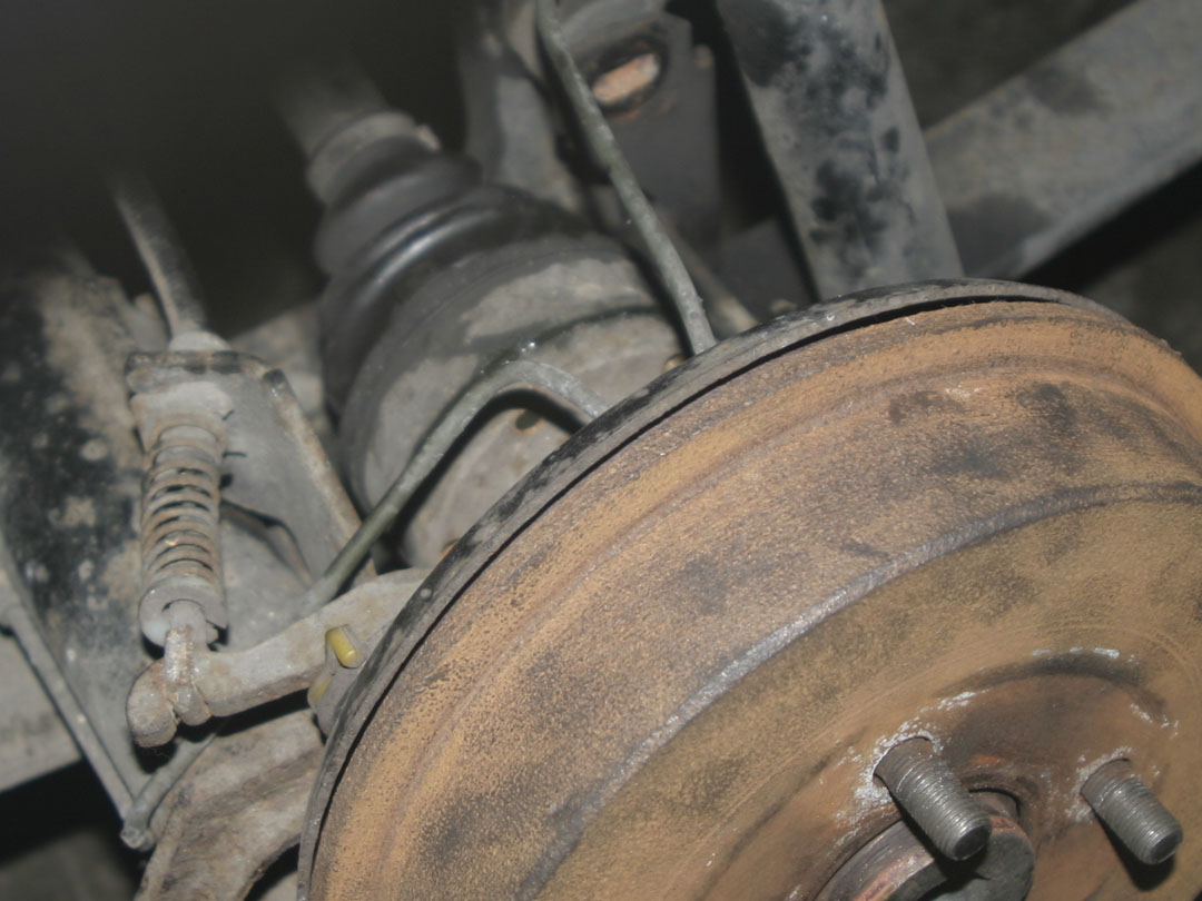

If I can offer any advice to anyone who's thinking of doing this then it would be to do he passenger side first, as this was a good bit easier, because it lacks the infamous anti-tramp bar and the steel brake lines do not obstruct the drive shaft.
I found on the drivers side that to get the drive shaft out of the way I had to take the bolt out that secured the anti tramp bar as this also held a brake line bracket in place. Removing the bolt allowed me to move the brake line over to create a bigger gap for the drive shaft to be lifted out of the way.

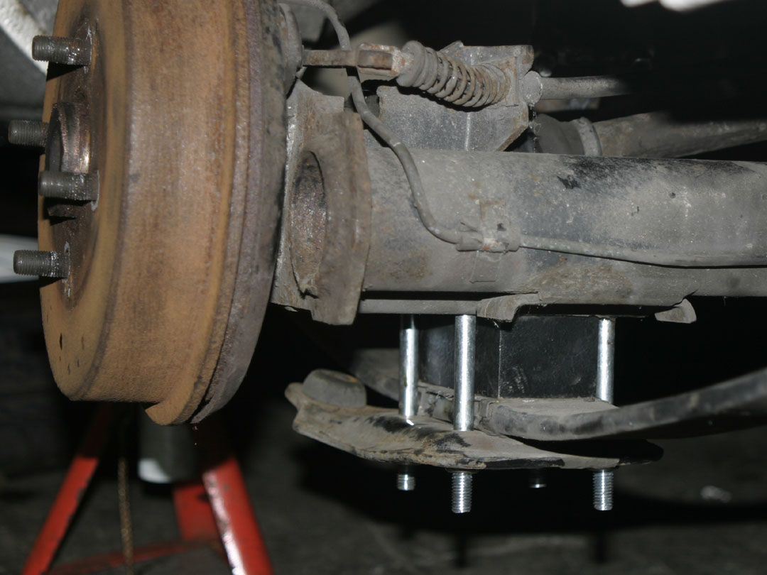

It took me comfortably 6-8 hours or so on a Sunday.
The most annoying bit was the drive shaft bolts. These are allen bolts, which on some cars are full of dirt, which needs cleaned out. After that I undone them. I found access to the bolts difficult so the sequence was:
Hand brake on
loosen drive shaft bolt
Hand brake off
spin hub a half turn
Hand brake on
loosen opposite drive shaft bolt
Hand brake off
spin hub
Maybe someone knows of an easier way to do this :?:
This was continued untill all the drive shaft bolts were loose and able to be removed, allowing this end of the drive shaft to be lifted out of the way (on the passenger side anyway), leaving easy access to the 4 bolts which secure the axel, leaf spring and bottom shock bracket.
You can now undo and remove the 4 nuts and bolts. I was lucky, very little rust and no seized bolts! If they are siezed atleast you dont need to re use them.
With the 4 nuts and bolts removed you can use a jack to lift up the axel.This should open up a gap between the the leaf spring and the axel, allowing you to position the lowering block in place.
After this is done the new longer nuts and bolts can be used to re attach the axel, leaf spring and bottom shock bracket (now with the addition of a lowering block).

The drivers side is slightly trickier because of the obstructing brake line (see photo).
After fitting the blocks I had a go at the Shocks.
This is simply a nut at the top and bottom which needs to be undone to allow you to compress (by hand) the old shock and pull it out. The landrover ones go straight in, but compressing them can be tricky because they are so stiff.
Im no expert, I don't mind being corrected, but doing it this way has not broken anything and Ive been driving the car loads.
Its improved things no end but to me feels a little undersprung?
