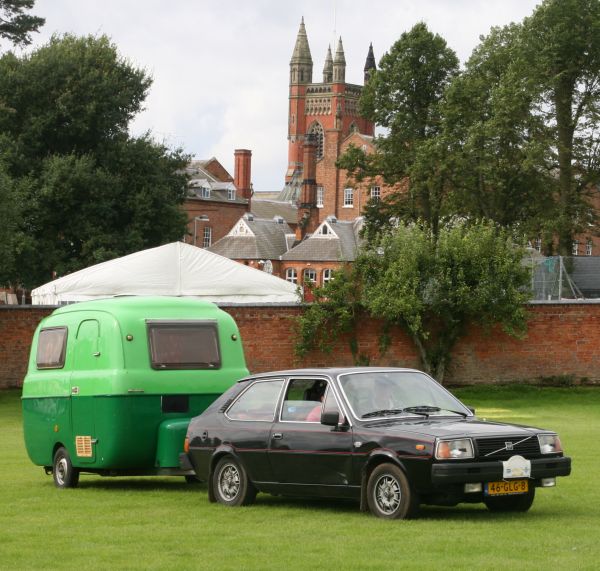

yes!, the cvt transmission can be used excellent for this. i'll have a pic up from Wouters Black Beauty in a minute

Oh yes! 1977 1.4 variomatic towing a 1960's caravan weighing probably over a tonne !(It said 1400kgs on the tow hitch), no problem! It was later fitted with a log burning stove (the caravan not the car!
) These photos were taken in the summer of 1993 when I'd just finished college and me and a couple of mates decided to bum around Dorset for a couple of weeks or so. Those were the days
Thats not me in the photos by the way...I took them!

Love the caravan with that 1970s orange stripe
