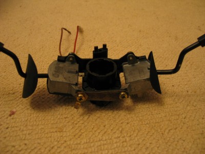

Here's one I repaired.
The top bracket should stop the switch from rotating too much, usually what happens is the bottom screw hole breaks out because it is thinner on the left hand side. A metal plate with 2 holes in it provides an robust repair.
A general tip is to use fingers to control the stalks rather than hands. My mate went through a few collars and I noticed he used his hand quite often on the stalks, when I only use my fingers. Sometime the top one goes aswell.
