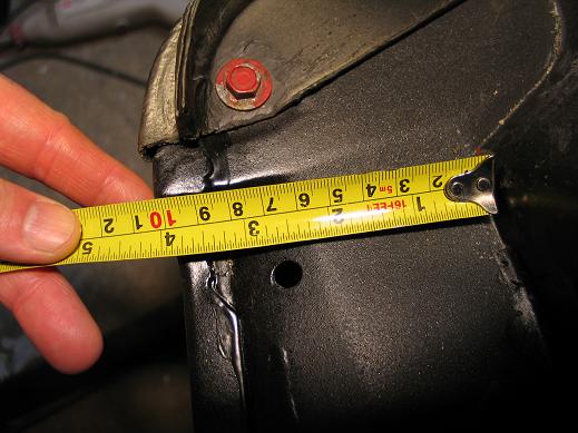

Unfortunately the wings don't fit too well at the front. Its possible I havn't fitted the valence back on well, too tight perhaps. The valence panels came from different cars so I didn't have the original spot weld holes to line up on. Suggestions, modify wing or reweld valence top bit? It may have to come off all the way along, next step is to try the other wing.
Foam in the air box wasn't too good. Replacement?
Wing doesn't fit well on the front valence
102mm ?? what does anyone else get?

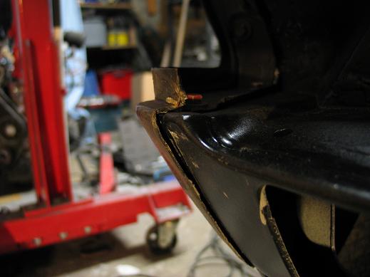

Post by Ride_on » 30 Apr 2014 01:21 am
Fixed one problem, lovely job, found another ..commit suicide!
Cut the rewelding out
welded up the gap, about 4mm, fits perfect now.

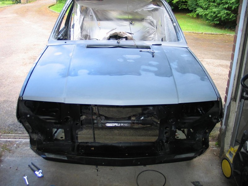

Post by Ride_on » 23 Jun 2014 01:51 am
Well I've been working hard to get the the spraying point. All doors and wings on now, boot ready and majority of cleaning and flatting done. Just about do the the stone chip and have sprayer coming for a quote this week. Some further photo's;
General state
