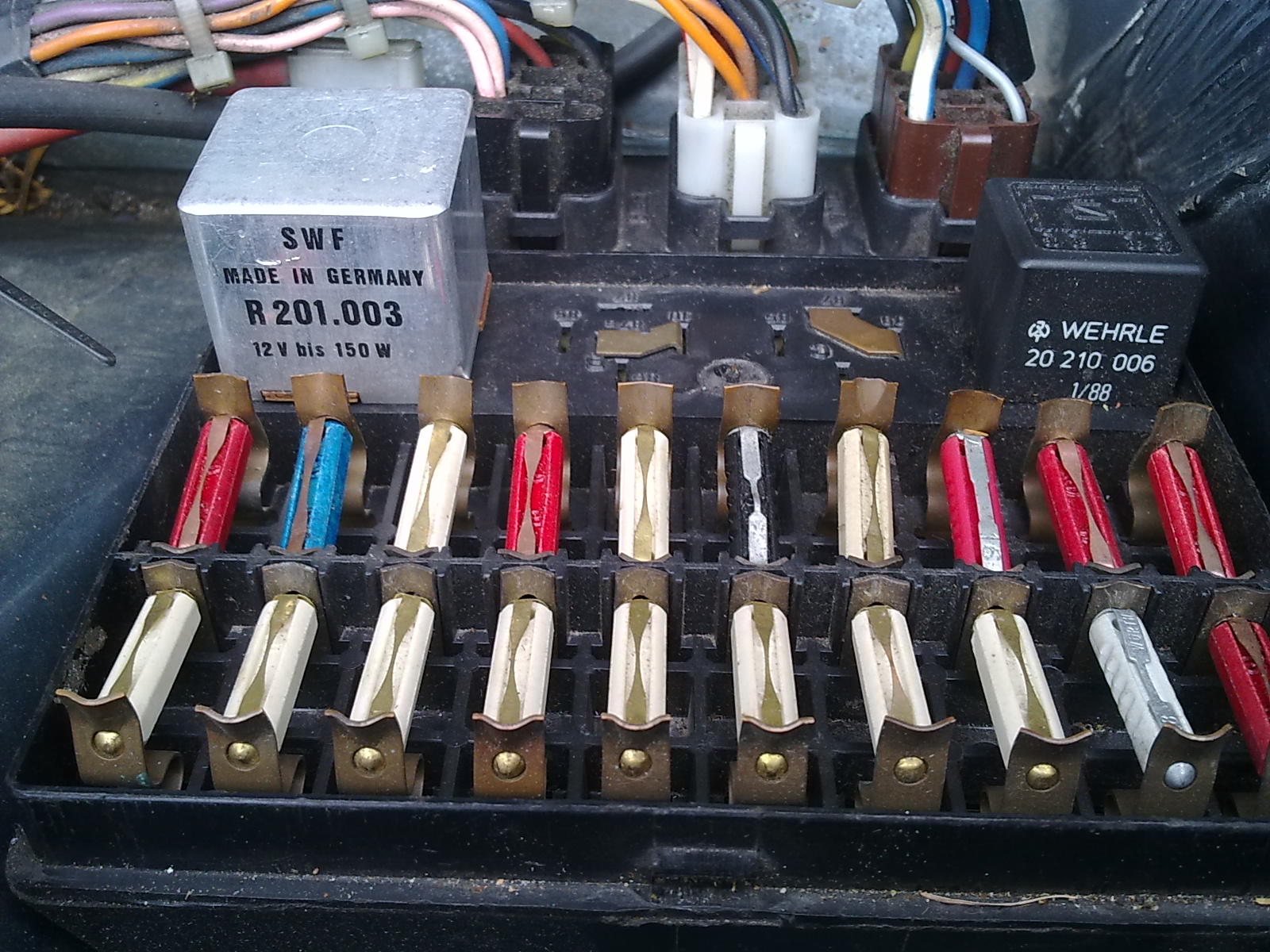

Any ideas what's missing from my 89 340GL fuse box?
A relay I guess, anyone got a part number?
Thanks.

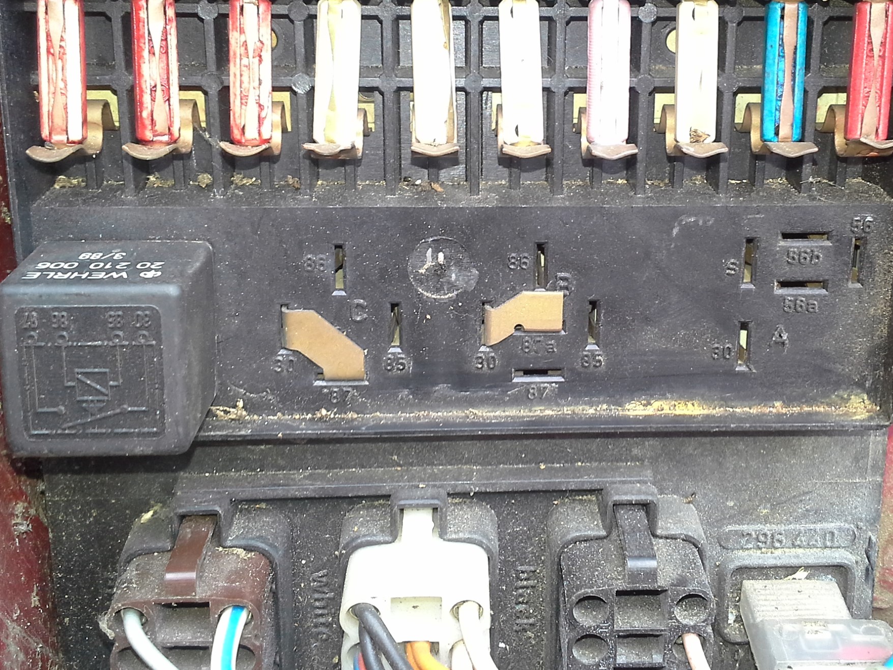

Hello, the two slots in the middle are usually empty on a manual car and the one on the right is a big silver one for the headlamps. The Haynes manual doesn't have labels in the relevant diagram but you can find the answer on page four of the V3M technical wiring diagram in the downloads section. Keep reminding me and I'll get the part number next time I use the car.

Hello again, I photographed the fuse box today.

Thanks for that, I've got one on order.
