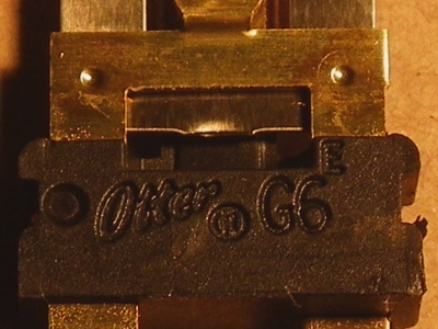

I can confirm that the inside of a new Otter G6 looks suspiciously like the old one, but not exactly the same.
Now...
then...
now...
then...
... Geddit?? I guess that's a bad sense of humour these days ;-)

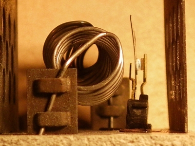

Down by the resistor side...

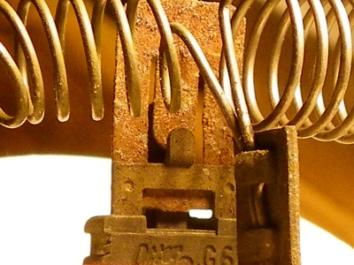

I have decided to have the shields refurbished by YZP plating and have accordingly been preparing them.
Very very rusty - either a lot of very delicate work - or 20 mins in 81% Phosphoric Acid --- Amazing!
