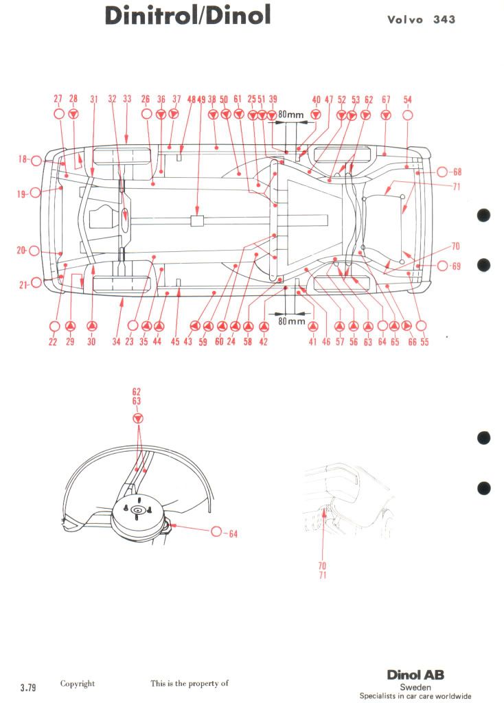

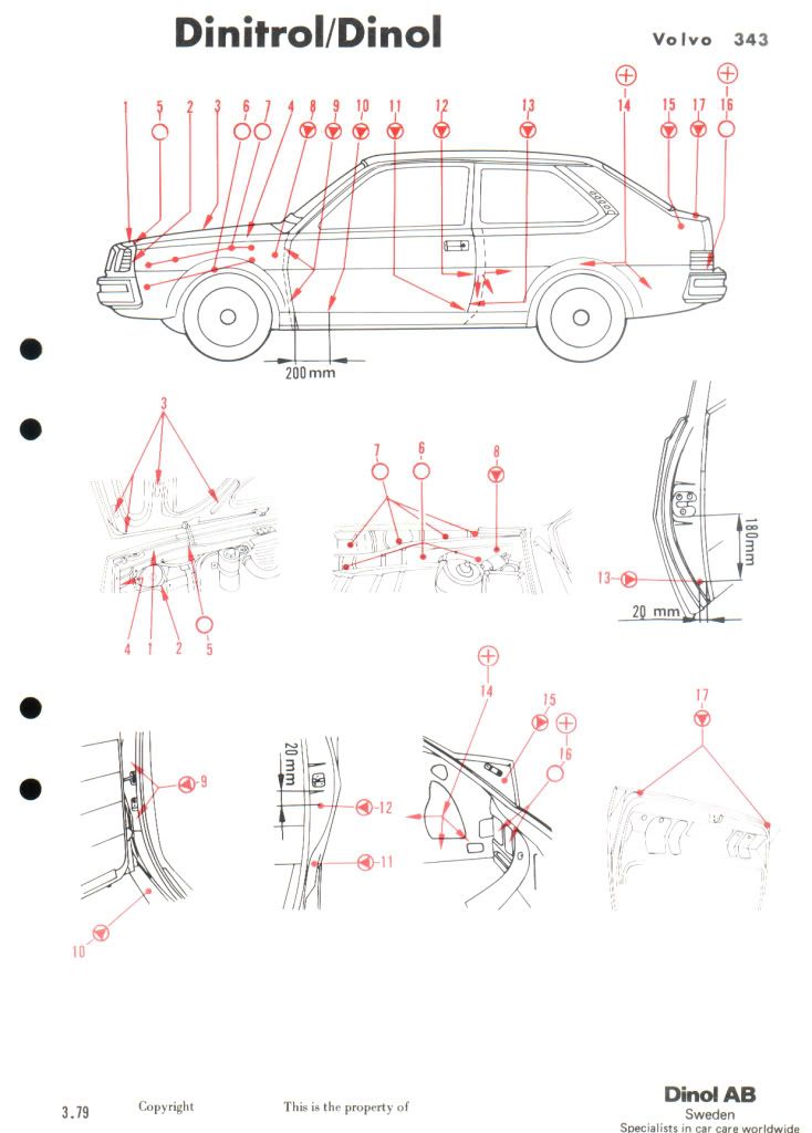

If anyone is planning to do something similar - these scans might be helpful:
The resolution on Photobucket isn't that great, unfortunately ...

Post by nomashedswede » 21 Nov 2008 03:45 am
VERY useful, Tom - where do you get this stuff ?!?!?! :D

nomashedswede wrote:VERY useful, Tom - where do you get this stuff ?!?!?! :D
+1... Tom, can these go in the technical section please :D
Post by trabitom99 » 21 Nov 2008 10:19 am
No point keeping these things to yourself, like Mr Scrooge :-)
Chris, I don't think I can post in the tech section. I'll email you the scan, that way you can put it up in better quality for a print out ...
Post by filthyjohn » 21 Nov 2008 12:02 pm
Very useful pics those. I was planning to ask if anyone knew all the relevant waxing points, so I can fill my whole car with Bilt-Hamber Dynax50 cavity wax.

I have the green book of how to waxoyl a 300 here too, that might be helpful... though I think Mac posted it once? Certainly there is a lot more info for the tech section!

Post by MJ » 21 Nov 2008 10:30 pm
Very useful, but what's the difference between the arrows, arrows with a circle, arrows with a circle containing a triangle and arrows with a circle containing a cross?
Post by Chris_C » 22 Nov 2008 12:03 am
Which noozle to use I'd imagine
