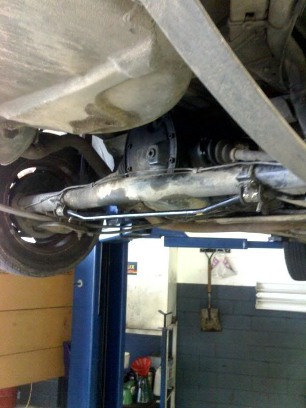

I should imagine there must be a link rod to the floor pan?
The picture does not show enough of what we need to see.

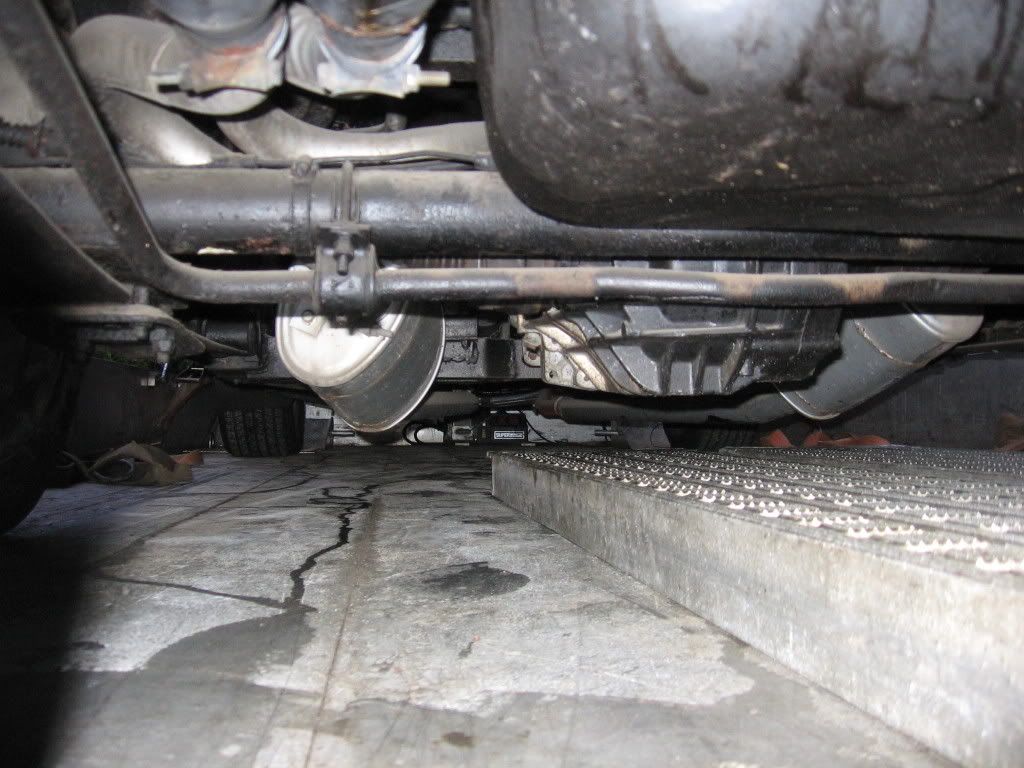

Looks to me like the bar terminates somewhere near the front spring mounting point, but its a bit blurry up there. Interesting
That 363CS swaybar isn't the best one either. I've been told that if the body side attatchment points are too far from the "center" of the "damping movement" (don't know how to explain it in english..
) the sway bar doesn't work anywhere near like it should. In this case the body side brackets should be as near the axle as possible, not at the end of the spring as they are now, because the axle is the "center" point which I tried to explain before.
The swaybar on the 363 looks like a regular one, as found on many many production vehicles.. You dont want to make those arms too short, they determine the springrate of the swaybar. The shorter they are, the stiffer it gets (and you dont need uber-stiffness), thats also why performance swaybars often have adjustable endlinks, so you can adjust it a little bit.
Anyways, can we get some better pics of that bimmer swaybar? Preferebly some of the endlinks..
