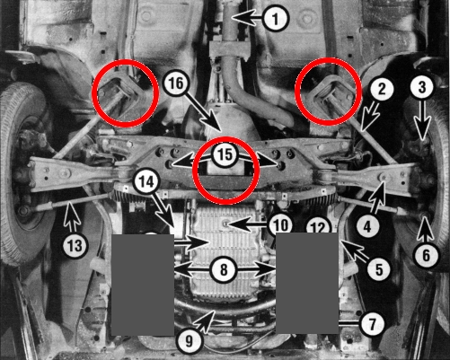

Sorry to revive an old thread! But I'm having much the same problem with my 1984 340 1.4. I'm new to mechanics so I'm learning the hard way what to do and what *not* to do! (Already tried using the car's scissor jack along with a ramp and axle stand to get the car high enough to slip an axle stand under the front jacking point, and had the car slip off the scissor jack! No harm done except damaged underseal (and bent shaft of the scissor jack!!), but I'm about to re-do with Dinitrol anyway... I think I got away with it this time!
I'm out to buy a proper trolley jack in a bit, but I'm slightly confused about where to place it and the axle stands when jacking up the front of the car (I understand the rear axle bit okay). I've seen a photo online of someone jacking up their 340 with the jack in the centre of the crossmember that the rear engine-mounts bolt onto (No. 15 in the picture) - is the the place 340GLT means when he says "front tierod mountings"? I've attached a scan of the underside of a 340 and circled the centre area I'm talking about.
Also, although I'm planning to use the front jacking points to place the axle stands onto, having had one slip off already I'm tempted to do what you guys are saying and place the stands elsewhere. I'm a bit concerned about using a block on top of the stands though, isn't that a bit risky? I know my stands have huge warnings about using blocks all over them! I've only got some softwood blocks here, so I'm guessing they wouldn't do. My question though is where else can I put the axle stands? You guys mention a strong bit of box-section, I can't see anything obvious on the left and right underside of my car, only the pieces where the engine bearer mounts left and right, would they do? (My car's got splashguards in the way there I think, like the grey rectangles in the scan). And am I right in thinking the "outriggers at the front" are the same as the "front radius arms" mentioned in my Haynes manual (No. 2 in the picture)? I couldn't work out where they "meet" as 340GLT said, I thought perhaps you meant put the stands at or just behind where the radius arms join the main chassis (where I've put the two red circles on my attachment)?

- Possible front trolley-jack / axle-stand points???
- 340gl-underbody.jpg (152.11 KiB) Viewed 11065 times

in the centre circle at 15. don't use the other circle's where 2 is attached to!
and don't use the beam at 9 either

The chassis rails are not really strong enough to lift the car - they tend to end up bent.
I jack from the front crossmember (15) and the diff casing at the rear...then put the stands on the jacking points.

Why not beam 9 Anjo? I have my 360 standing on 2 big standards now, and one is on beam-9 with a wooden block in between and the other is on the rear beneath the chassis-beams on wooden blocks. I can't use the jackingpoints as i am welding them.

I think I'll go for the centre of the crossmember (15) and the jacking points for the axle-stands as foggyjames and volvodspec suggested, sounds good to me! I'm *really* grateful for knowing to avoid the front radius arms (2), I'm sure there's a good reason for this so you've probably just saved my car a busted suspension or something!!
Didn't think about using the leaf-spring clamps though - that might come in real handy.
I'd also be interested to know why you shouldn't use the engine bearer (9), is it because the bearer curves upwards so it'd be easy for something to slip off it? It looks damned sturdy and goes straight onto the chassis...
foggyjames mentioned the chassis rails not being strong enough - I'm *really* new to this so I don't actually know what the chassis rails are!
I'm guessing they're the sections (underneath the '7' in the pic) the engine bearer / mounts and suspension bolt onto? Seeing those pics would be great Jos360, it'd be useful to know where to use the wooden block safely in case I need to. Really sorry to hear about the damage by the way! That sucks

cause it's mounted in a bend forward (seen from the side); and not straight to the top. if jou lift the car here you can risk bending the mounting plates or/and setting the beam out of it's model.Jos360 wrote:Why not beam 9 Anjo? I have my 360 standing on 2 big standards now, and one is on beam-9 with a wooden block in between and the other is on the rear beneath the chassis-beams on wooden blocks. I can't use the jackingpoints as i am welding them.
not a very "big" issue on a 360, but 340 is different story since engine mounts are on that beam too..
jacking on the chassis beam is indeed possible; but only on a few strategic places and with a spreaded support for the jack as jos360 says.

Dave - the chassis rails are the two 'beams' which run front to back along the floorpan. It's very tempting to try lifting the car on them...but I wouldn't! It's relatively unusual to find a car with totally straight chassis rails, courtesy of some muppet. In the case of my 360, I was responsible for a good chunk of the muppetry...but it is 6 or so years ago. I soon learned my lesson when I saw what I'd done!
The curved front crossmember is quite thin-walled, and can't take the weight of the car. They tend to bend if you try. The main crossmember is much stronger.
I sometimes use the axle for stands (but not for jacking, as it's more effort using a sprung part of the car, so I avoid it if I can). Usually, if I've got the rear of the air in the car, I'll need access to something in that area, and the stands just get in the way. My cars all have solid rear jacking points, so I'm not worried about that. I did get a surprise with a scrap car though....I tried to lower it onto the stands, and the car returned to the ground with the stands firmly embedded in the sills!
