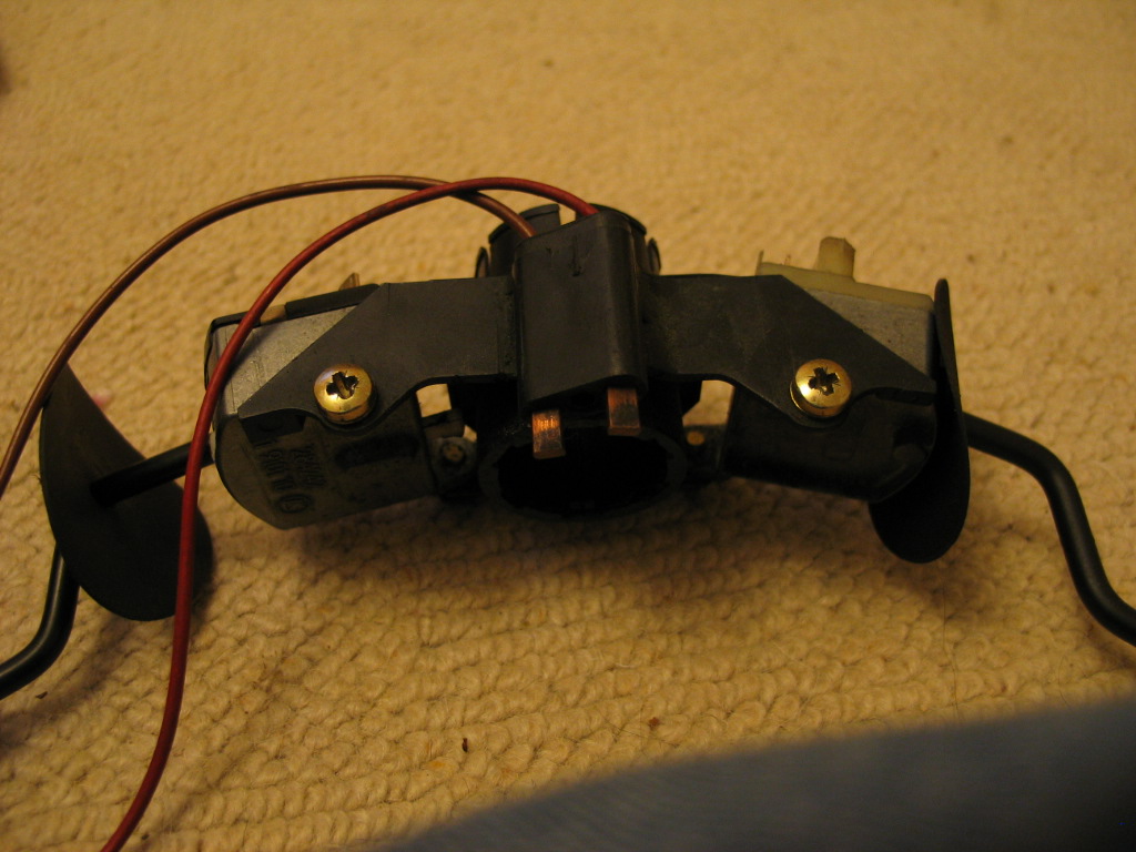

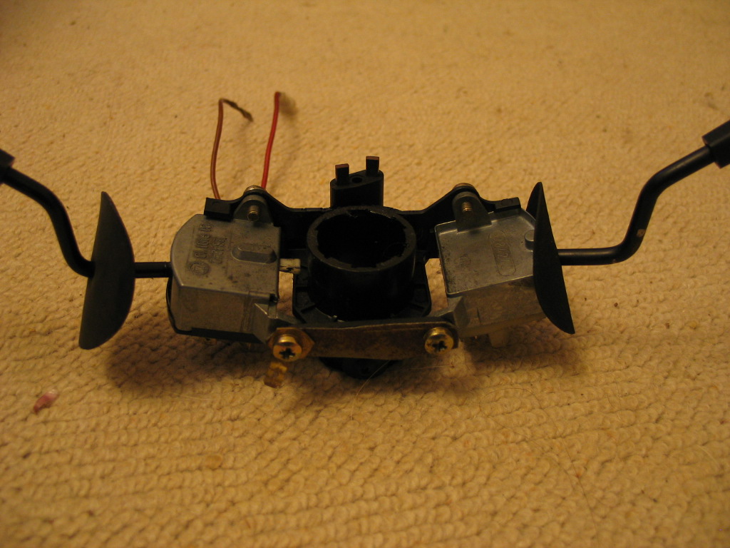

Here's one I repaired earlier, but it was just cracked on one side of the hole at the bottom. The plate I made was crude but effective, make sure you hold it with a proper clamp and not fingers while drilling!

Re: floppy indicator stalk
If you go to the board index and then go to offers 340 GLT is breaking a car down and may have the part you need.

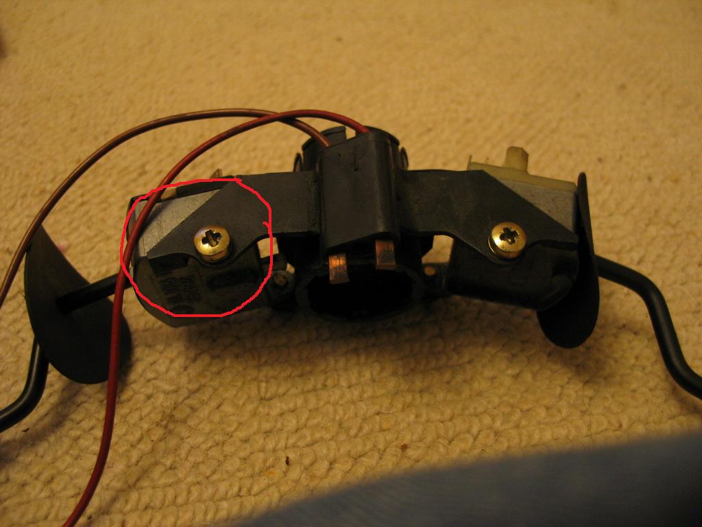

mine has already been plated at the bottom and it seems now that the top has snapped where shown in the pic.
any ideas how to repair witout having to buy a new one??

i think i will have to put a humped plate on as the plastic has broken right back near to the horn connectors. it looks like someone has been there before as there is a maze of cable ties.
the line shows roughly where its broke.
Boy that didn't leave much to play with!
It could still be done off the one side but would entail making up the missing piece out of plastic (cd case or similar), useing other side as template. Making the new piece fit perfectly on the end of the break and glue it to it, then strengthen the joint up with fibreglass top and bottom (good preparation of the parts will be the key factor if you want it all to stick together and stay there). The only down side to this is getting a plastic that won't melt under the heat of the glue bond or fibreglass! Some plastic cases hold up better then others to the heats but can be a hit and miss affair in finding one that won't melt.
Bridge idea is looking the easier option now but make sure the strip you use to do it can be easily shaped but not to flexible otherwise you will have problems with right turn signals eventually and would then cause more strain on the bottom mount. Make the bridge plate long enough so you can use the screw from the right hand controls and put a small self tapper, as suggested by Ride On, through the new plate but on the right side plastic arm to stop any front and back movement. Don't forget to make a pilot hole for the screw otherwise you may have the right side arm snap.
That is a bugger, you could still use a metal plate but it will need to be bent and shaped to match one side of the hump at least. Basically you need to increase the surface area for gluing.
Not sure why morgan105 is suggesting using CD case or whatever, I presume the original plastic is still there, it just needs reinforced. Fibreglass or Alradite does not produce enough heat to melt plastic (that I have eve seen), however it may chemically dissolve some.
