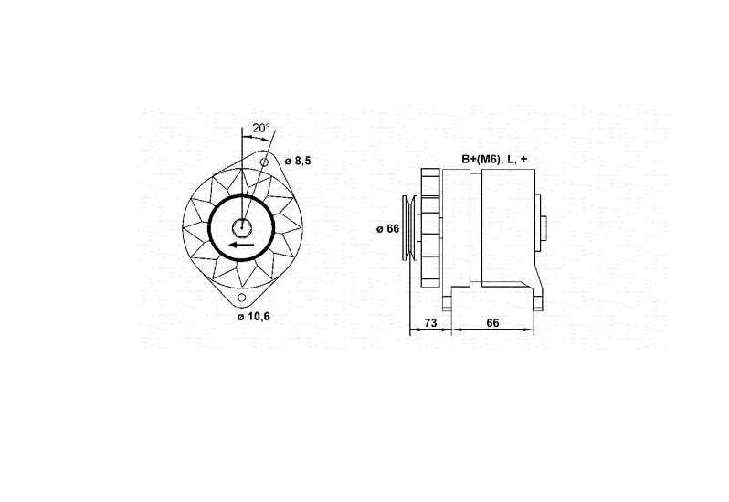

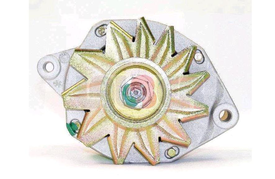

can you, please, tell me, what kind of alternators ar used with 1.7 carb engines?
it's about mounting points.

so, it was the second type of mounting, if it makes sense to anybody
