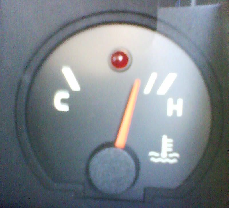

My Williams lump seems to be running hotter than it normally does. I have changed the thermostat and if anything that may have made it worse. The fan does not seem to make any difference. (I bypassed the fan switch to make sure).
Im not ruling it out but there does not seem to be any signs of Head gasket failure.
The oil and coolant are both fresh. Oil runs at about 90c
Any ideas?
And what sort of scale does the gauge use?
(current running temp)

Gauge position looks normal to me for a fully upto temp engine but other cars sit lower - depends on the stat. How quick is the temp coming up? Have you flushed teh system through with clean water?

You reckon Dai? Not sure about 340's but my 360's all sat right under to slightly to the right of the LED

The stat is a new lower rating. 82c if i remember correctly. yeap the system has been completely flushed.

The F7R's also seem to be designed a lot more with FWD in mind on the cooling system, mine runs between a third and half a gauge when running, about 30minutes colder with the heater on. Only in traffic will the needle creep past vertical and teh fan should kick in at the end of the LED still :?

it never used to run this warm, my F7P used to run at just below Half and this F7R used to run just above half. no idea why its started running warm.
