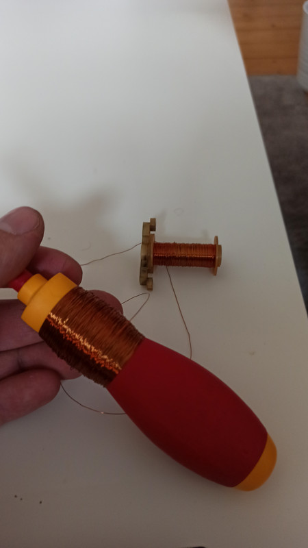

Post by IceTRex » 23 May 2022 05:03 pm
Here it is, sadly it's the beginning end not the end end😂 that you can see on the right connector

Post by bogbasic » 23 May 2022 07:48 pm
Cool photograph. Just a thought and it wouldn't need to be anywhere near as complicated ;-?
https://youtu.be/FM4xuE9LAeQ

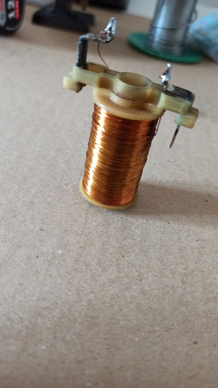

Post by IceTRex » 23 May 2022 08:00 pm
We did just that, but thanks for the idea!
Resoldered the but to the connector and now getting the same resistance as with the other coil, so should be alright now :D

Post by IceTRex » 09 Jun 2022 09:16 pm
Well, i havent written for quite a time now...
I managed to get everything going again finally.
Coil works perfectly, had to replace the diode and the transistor in the relay, installed the backup diode aswell :)
now everything works how it should, I am really happy :)
