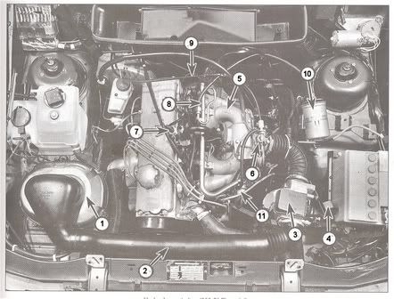

Where is it located on an '86 360 GLE 2.0? Is it behind the dashboard? Cause, I had mine replaced the other day, and when I came back to pick up the car, I saw the indicator stalk had been broken?! :shock: The guys at the garage swored they had nothing to do with that...didn't want to pay for the new one, though, but nevertheless, I don't like being lied to...

On a 360 injection, the 'fuel pump' relay is incorperated in the system relay that also powers up the ECU. It's located in the engine bay between the air mass meter and the battery - the pic below shows it (it's item no.4).
(On carburettor cars the mechanical fuel pump has no relay.)
Sorry mate - if all your garage changed was the system relay there was no need for them to go behind the dash (assuming they knew where the relay was of course).
All the best - Mac.
