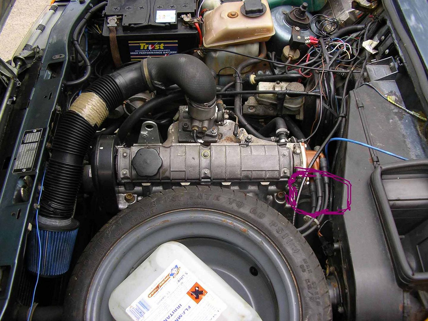

or you coulddo what I did when my carb packed in
That is a throttle body off a k jet b23 with adaptor plates onto the carb manifold.

That would would drop in. The only issue is that one is a single point injection and I'm not sure the injection unit would clear the bonnet.
Is the one you have multi point?

Dai,
Is that a singlepoint injection you bolted onto the B17 engine?
If so, could you give some more info, e.g. was it simple bolt-on or did stuff have to be modified? And you talked about adaptor plates...
I am very interested, as my carb is not as pretty as it should've been...
