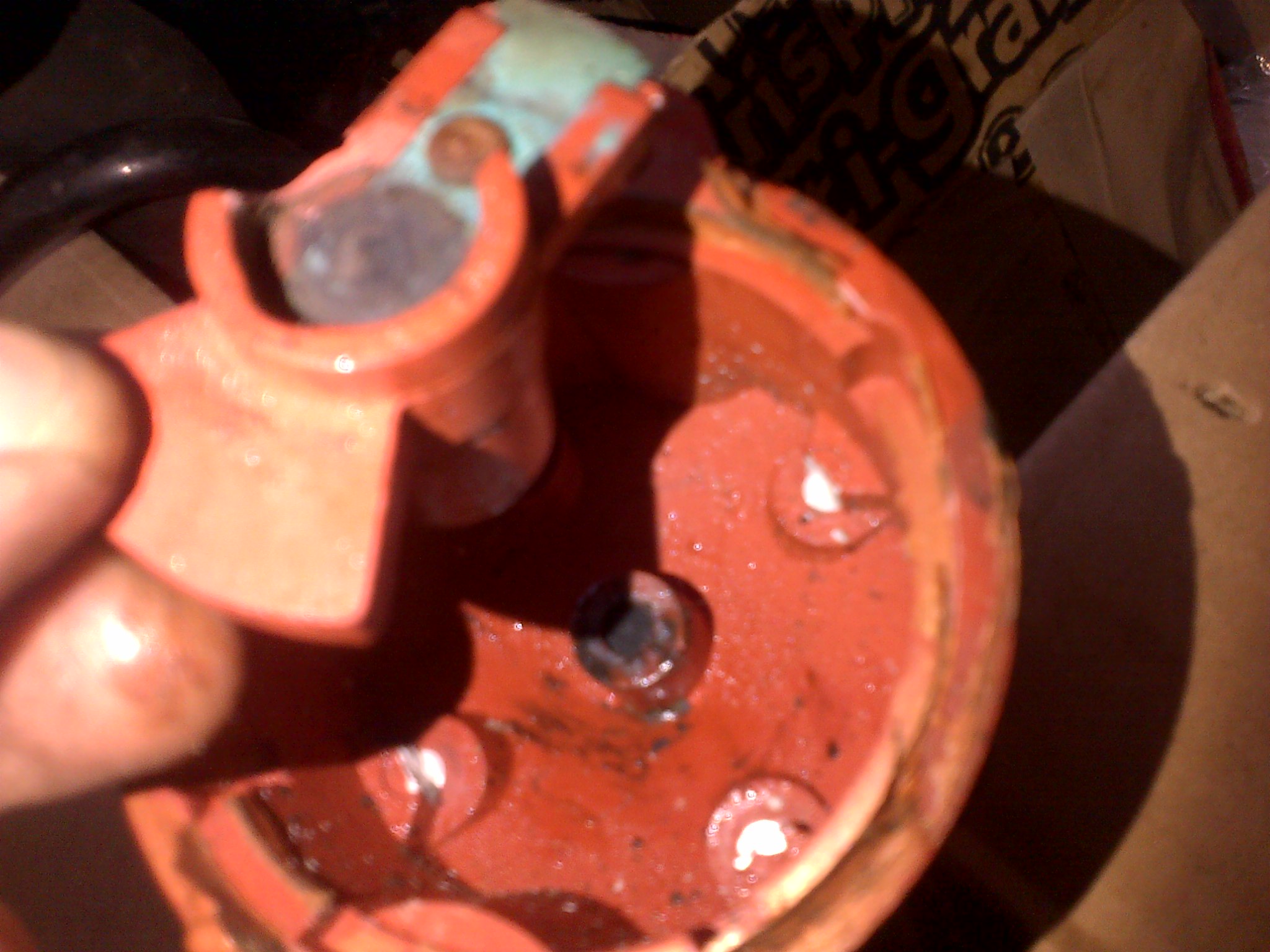

The dizzy cap+rotor, which I sealed (experimentally) was so f*d.. (Photo)
I've replaced it with a slightly cracked dizzy cap, cracks only penettrate a mil or so so I drilled out the carbonized cracks and smoothed the internal surfaces- hey presto- totally sorted at last!
See the burned out center electrode, bits missing off the rotor arm, zinc all over the place, copper carbonate and condensation and the fact this engine actually RUN! - volvo!!

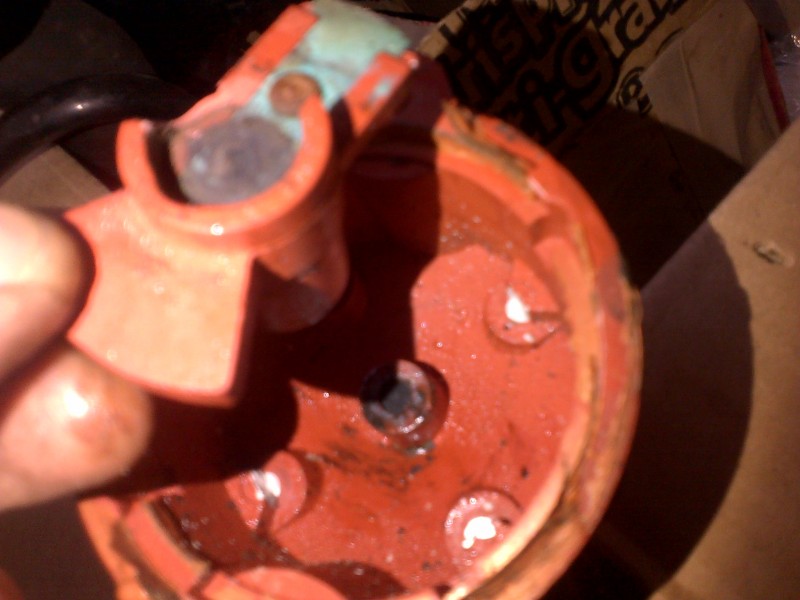

And.. Well..

Combination of flange-leak, dizzy and accell diaphragm.
Its so sorted! Instant start all the time!
Smooth and torquey.
