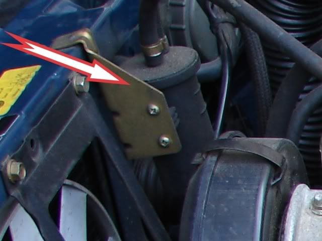

I'd reckon that an inline would be ok between the pot and the pump.
Is there anyway of looking inside the 1.7 pot? Sounds like a tiny swirl pot, I remember MJ's car had one, and it wasn't big enough to be much use as a swirl pot!
Yeah, I remember at the Taunton meet some of you guys were looking at some Red Bull can sized thing at the front *gets idea*.
Luckily I seem to have caught it in the corner of a photo unintentionally. Here it is.

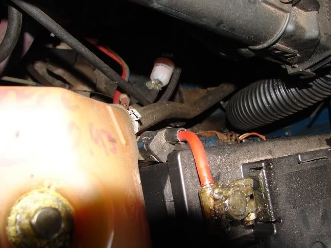

I also spotted this in another photo. Is it something to do with fuel? It says: FB 629/24/5
Made in Austria (I think it's Austria not Australia) Gotta love good cameras
