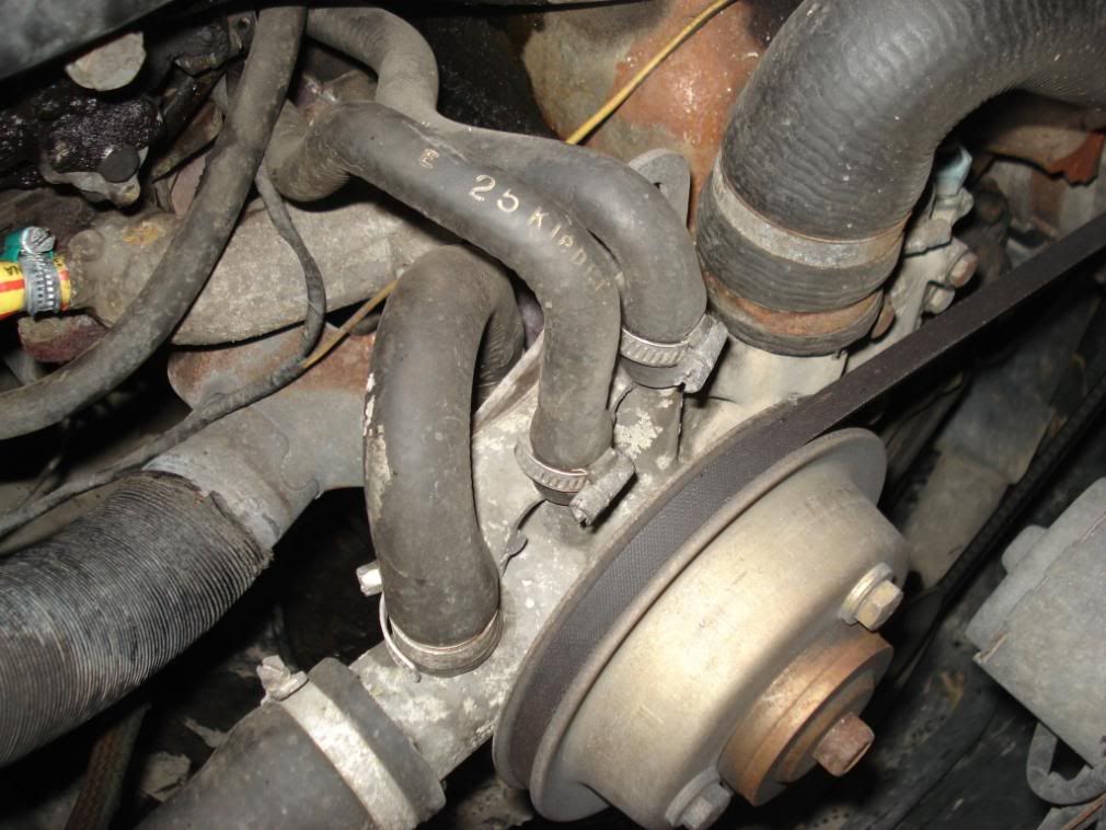

If i spray start gas near the three hoses on top of the water pump here the engine revs up.. what are these for?
Is this the restrictor thing?

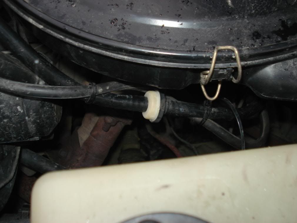

Here's the gardena thingie..
I think it has something to do with the brake vacuum?

The 3 hoses are just coolant hoses and go to the manifold and heater, you should'nt get an increase in revs by spraying on to these. The only reason for an increase in revs is that the spray must be getting in to the carb (may just be getting pulled in through the filter as the end of it sits around that area or carb may still have a leak in it at a gasket somewhere, looks awful wet).
The plastic piece in the tube is the restrictor for vacuum so you do have that.
The hose piece is ok to use for the connection but what I would suggest is to replace the piece of wire with a jubilee clip like is on the other end as if it's not producing a good tight seal then you will get a leak from that point.
With the carb being so wet looking it may still be leaking or it may need a bit of adjustment. Also check your breather hoses to make sure they're not blocked especially the one from the rocker cover back to the t-piece connector (also check that) that takes the pipe to the bottom of the carb.

That is the filter or one-way valve for the brake servo vacuum hose...I presumed we're talking about the restrictor in the vacuum line which forms part of the breather system.
That one is usually very well hidden in the hose which runs from the outside edge of the base of the carb around to the port in the rocker cover. You'd barely know it was there if you weren't looking for it...the hose is in two halves, which are pushed onto the restrictor, covering it completely.

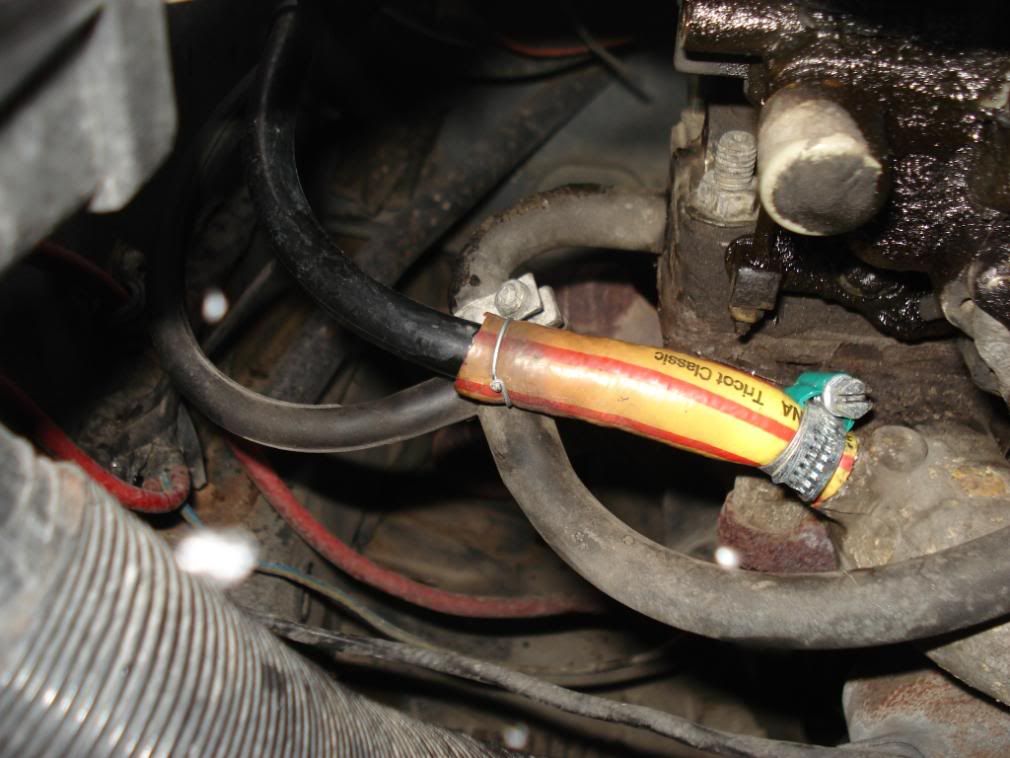

Hm. The gardena hose is the brake servo vaccum hose, which attaches to the one-way valve. The brake servo is working, but i assume that hose isn't 100% airtight, so it should be removed & replaced.
Now the other hose you're talking about, does it run from the base of the carb, into a T-joint, and then into two other places (i assume the rocker cover is one of them)? The restrictor is somewhere in that?

There is supposed to be a short piece of rubber hose linking the plastic servo pipe to the inlet manifold. It looks like someone was a bit creative with the replacement when the original split :) It looks like you could improve on their work, yes...
That's correct. The hose runs from the base of the carb to the T-piece, and the two ends go to the rocker cover and the airpan. The restrictor should be in the second between the carb base and the T-piece. You can tell if it's there because the pipe is a bit hard & straight there...but its pretty well hidden! For this reason, they often get replaced with a straight piece of pipe, which effectively introduces a huge vacuum leak.

Doesn't the carb look very wet in those photos? Something's not right.
Do you guys think it would be a good idea to give the carb a refurbishing and go over all the vacuum hoses and replace pretty much every vaccum hose i can find? I guess 21 years is too much for a rubber hose :?

It is pretty well caked in grease there. A rebuild certainly can't hurt, and isn't difficult to achieve.

I think i found out why the carb looks so wet, it seems the petrol hose feeding the carb is leaking in the area where it meets the carb.
