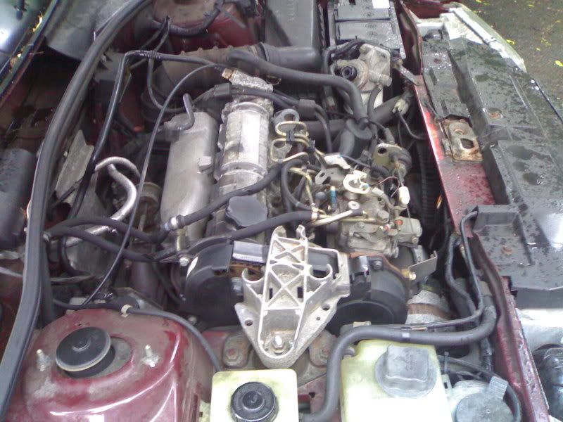

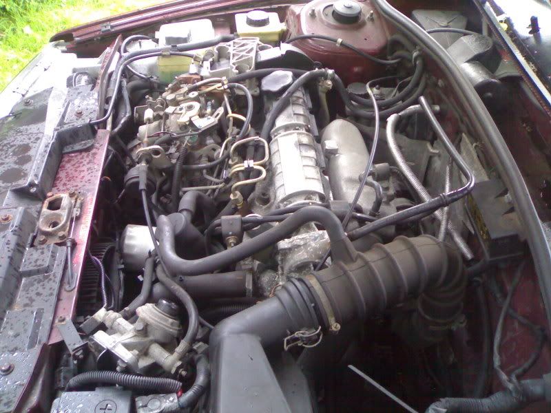

Chris.. got your pics yesterday as Sharons 440 TD was a little juddery in 4th gear (low revs I guess) after starting from work. wouldnt start at all on friday and couldnt get it to go on sunday. it started but soon stalled.
got some underbonnet shots for you.
Carl, diesels having no BOV? Im sure there is vaccum accuator on the side of my 440TD turbo..
getting a green book from volvo so will hopefully be able to figure what the problem is...
glow plugs ok, powering up for the correct time
stop solenoid seems ok but need to check cold start solenoid as that changes timing for cold starts.
I'll update here in case its helpful for 1.6 340 people - do they also have Lucas CAV pumps? and for anyone getting a 440TD for their 340!

I'm very sure the 440TD will not have a BOV as standard. You sure it's not the wastegate actuator?
As for your problems, sounds a bit like there could be air in the system. Or maybe a blocked fuel filter.

If this valve in on the side of the turbo, rather than on the intake pipework somewhere, it's almost certainly the wastegate actuator.

Interesting - very much like the B172, but with what I assume is a vacuum pump on the end of the cam?
That's definitely the wastegate actuator in the last pic.

Awesome, looks like the intake manifold doesn't need touching by the looks of that, so it's just exhaust... what are the odds of a square 4 bolt flange on the mani/downpipe fitment
