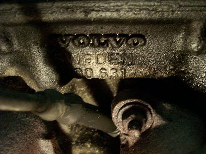

foggy where can i find info on what engine ive got in a 2.3 740?

Post by filthyjohn » 07 Mar 2008 03:13 pm
It will have the code printed on a sticker at the top of the cambelt cover. Other info beyond that is indeed Foggy's department.
Post by foggyjames » 07 Mar 2008 07:00 pm
It'll be a B230K. Which version it is depends on which year it is. Look for the code on the head between exhaust ports 2 & 3 - starting 1000xxx. It'll either read 530, or 631. 631 will be from a later car, and is a 'Heron' design (with the combustion chamber in the pistons, and a flat cylinder head) like the Renault 1.7 in the 340.

Post by germ » 07 Mar 2008 08:13 pm
Thanks very much john and foggy,
tis a :
so no good for tuning then :(

sadly no, a pretty horrible engine setup for simple tuning :(

Post by foggyjames » 08 Mar 2008 02:23 am
Nothing wrong with it...it's just useful to know that there's no point in looking for a 531 head for it! Not that a stock 531 is a worthwhile upgrade anyway...
Stick a set of Webers on it, and you'd be laughing. It's probably a better behaved chamber than the standard 530/531 layout anyway.
