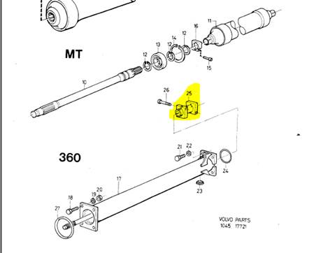

Can I add a question?
Has anyone replaced the flange that`s visible in the picture, the one connecting the gearbox to the torque tube? Does replacing it with a stronger one help sorting out the fragility of the drivetrain?
- Posts: 5465
Re: 360 Gearbox frontplate to Torque tube bolt thread
I've never know that part to fail. The common failure is the clamp that holds the Torque bar to the gearbox. The splines tend to give way there
- Posts: 44
- Joined: 16 Jan 2013 02:43 pm
Would that be no. 25?
- Posts: 5465
That's it.
