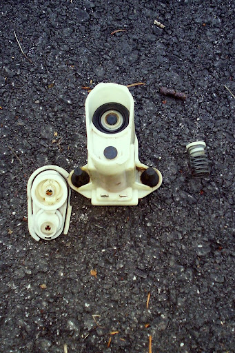

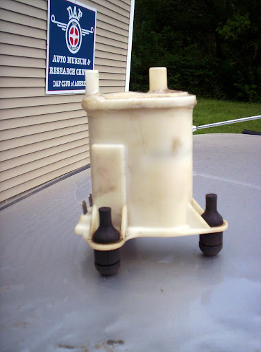

As far as I knew...the servo was not meant to be serviced. I did it anyway.
On my Type 1 someone had bypassed the Servo with a doorbell button because it did not work...
After carefully cutting around the top cover it was removed.
This will give you an idea of what is inside. I replaced the O-Rings and lubricated the bellows with PB Blaster (a rubber lubricant).
After that the cover was glued back on to seal it...
Have not had a problem since.
