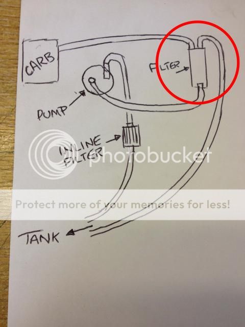

Ok.. so below I have drawn my fuel set up on the B172K.
Firstly does it look correct? I'm guessing its not far wrong as the car runs.
From my picture, which of the two lines that go to the tank are the return and supply? top or bottom etc.
Secondly where do can I source a 3 port fuel pot / filter like the one in the red circle? Is it even needed?
Thanks

Just run without it, you'll notice the difference in fuel aswell. Just put the pipe from the pipe *can go through another inline filter* straight to the carb.

i think im being slow.. I cant really understand which pipes to go where? do i just do away with the return?
or could you tell me which numbered pipes go where... i've even done another photoshop to help :D

It's not a filter - it's a swirl pot/vapour separator.
You can run without it but you would need an alternative fuel pump - you must maintain the return to tank.
On your system the pump feeds the swirl pot, the return is taken from the swirl pot, and the swirl pot feed the carburettor.
From chassis no.735603 the swirl pot is discontinued and the pump feeds the carburettor directly and provides for the return to tank (pump has an extra connection).

Loose 1 & 5 and connect 3 (plus another inline filter) straight to the feed for the carb
mac, why do u need to maintain the return? My mk2 fiesta had a return but wasn't used and the pump just fed the carb. I dont see why the return is necessary myself but happy to be told otherwise. :)

I'm tempted to say "because that's the way it was designed" but there are at least two obvious reasons why a fuel return is a good idea (can't speak for your Fiesta - it probably knows more than me).
The "simple" reason is that the pump operates at a higher pressure than is ideal to be controlled by the carburettor float valve - a calibrated fuel return reduces the pressure being fed to the carb. Without a return anything other than perfect valve sealing would result in fuel bypassing the control and "overflowing" from the float chambers into the venturii. Result grossly rich mixture.
The second reason is more complex and requires an understanding of how a combustion engine works. Basically your engine is a device that converts chemical energy into kinetic and heat energy. Fuel is mixed with air and compressed within a cylinder and rapid oxidisation is initiated by an electric spark (an explosion may not seem to a chemical reaction but that's what it is). The reaction creates an over pressure event which translates into kinetic energy (piston moves down and crank rotates) and a great deal of heat which is wasted to atmosphere (ie:- heats the air up in the engine bay). The colder the air surrounding the engine is - the more chemical energy is wasted as heat (leaving less to "do work").
If the design of the car allows the engine bay to run hot it minimises this heat rejection from the engine block and allows the engine to "turn" more of the fuels chemical energy into "work".
However it is NOT a good idea to allow the fuel to become too hot as this leads to vapour formation (and mixture fluctuation) or even to vapour lock (where the pump simply compresses gaseous fuel rather than pumping). On the B172 especially, the pump (sitting on top of the cylinder head) is very susceptible to heat soak.
A return to tank (whether from the pump directly or from the vapour separator) allows a constant flow of cooler fuel (from the tank) to replace fuel from the engine bay that has absorbed heat. The fuel tank act therefore almost as a radiator or thermal sink.

Most carb engines do not use a return but the pump is driven via a cam in the block with a plastic isolator to keep heat down.
On the B172 the pump is neat the exhaust and up high so the pump is exposed to a lot more heat than most engines. Allowing a constant flow of fuel through the pump keeps the temperature down and stops the fuel vapourising in the pump.
Basically what Mac has written but condensed down

mac wrote:From chassis no.735603 the swirl pot is discontinued and the pump feeds the carburettor directly and provides for the return to tank (pump has an extra connection).
Mac.
I took a quick look at the setup on my friends 88 1.7 earlier and i couldn't work out why i had the swirl pot and his didn't... well that explains it! upon looking i saw his had the 3rd port for the pump. i'm tempted to do away with the return feed just for now to get me by as i think im having issues with my swirl pot? will the 3 port pump fit exactly the same housing as my 2 port one? probably best to keep the return in the long run and ill just use his reg plate number when ordering and make sure they supply me with a 3 port one.
